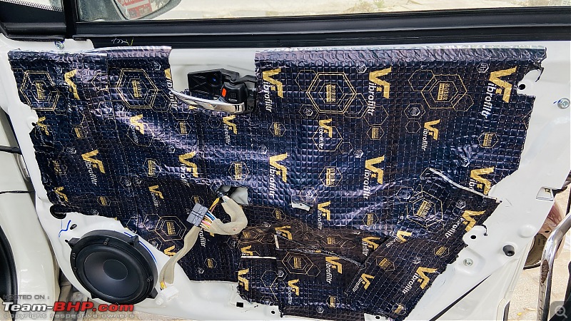

Update: I installed Vibrofiltr damping sheets today in my S-Cross.
Product: Vibrofiltr 2.3mm damping sheets.
Price: Rs900/sheet.
Place: Kalra auto accessories, Sector 50, Gurugram (Delhi-NCR region).
Quality of work: Poor/pathetic.
They used 4 sheets for driver door (four). Three sheets were used on front passenger.
Issues: The use of roller was paid I guess. They used roller for around less than half the sheets. I am sharing the photos. The work was so shoddy that I stopped the work and didnt get rear speakers or damping. I am attaching photos and you can see that the edges of many damping sheet pieces are not even rolled properly. They will eventually fall off in due course of time. Correct me if I am wrong. My Punto was damped with 10 sheets of DampMat in 2013 and the quality of work was proper inlike this one.
Avoid this place. I contacted Motor Concept by the way and perhaps they install higher end equipment (amps+subs+capacitors+speakers+damping etc). They sort of consider JBL GTO series as local stuff so didnt avail their service.
