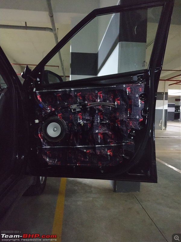

Re: The Damping Material and Sound Deadener Thread
Got the vibromax damping done last Sunday. Good vfm damping. The boot will be done this weekend.
