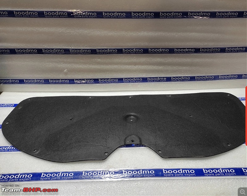

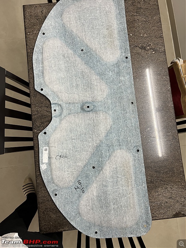

Came across a Russian product on the net called ‘STP Heatshield XL’ that does not require to be pasted or fixed to the hood. It simply has to be laid over engine bay, and fits snugly once the hood is closed. Claims that it reduces the engine noise as well. However, the product is not available in India.
Inspired by the same, I obtained a spare hood insulation from Boodmo for TATA Harrier for Rs.1,400/-. I plan to simply lay it over the engine-bay just like the ‘STP Heatshield,’ such that it aligns exactly with the stock insulation matching the indenture beneath the hood, and close the hood. Since the space between the stock insulation and the engine-bay is minimal, the hood should hold the additional insulation tightly. The side of the TATA insulation facing the engine-bay appears to be flame retardant.
Is it okay to go ahead, or should it be avoided at all costs?

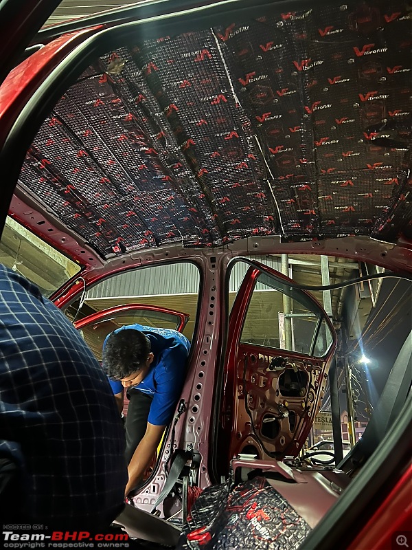

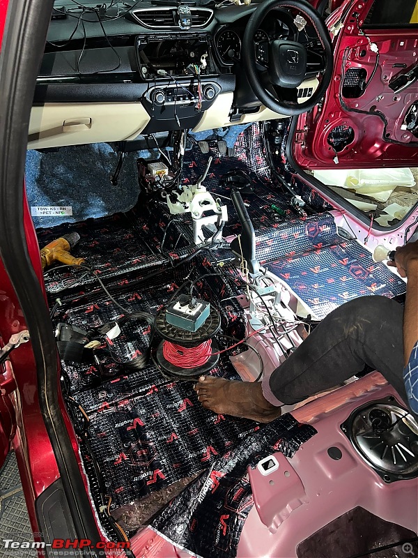

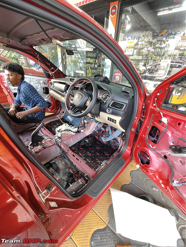

I got damping done on my 2019 Honda Amaze Diesel. This has been something that I wanted to do for a long time and finally took the leap last week. One thing that I hated about the Amaze Diesel was its NVH levels and the poor audio quality. With the stock headunit, the audio quality was very dull and I preferred riding with no music in the early days of my ownership. As the car aged, there were vibrations coming from at least one of the panels all the time which was a bit irritating for me. So, to mask the vibrations and the rattle, I started to listen to music on the stock head unit and the poor audio quality forced me to upgrade to an Android head unit with DSP. The result of the upgrade was quite surprising as the audio quality on the stock speakers were lightyears ahead. Recently, I have been doing a lot of long-distance drives and extensively listening to music during my long drives. This created a need in me for improving the audio quality and the overall listening experience.
As the first step, I installed a pair of tweeters from Hertz (Dieci DT 24.3) on the front. The tweeters were capable of producing distortion-free music even at higher volumes and they were totally worth the Rs 3500 spent.
Now, one remaining problem was the rattling of different panels at higher volumes and at higher bass settings. So, I started my research on damping on this thread and unfortunately couldn't find anyone who has done damping on Amaze. There were a couple of YouTube videos with details regarding damping on Amaze but they weren't enough to give a clear idea about the benefits. I was not sure about the cost Vs benefit aspect of the damping.
Finally, last week I visited some of the car accessory shops nearby and decided to do damping from the shop that showcased more damping works. Their Google reviews were also good.
They quoted Rs 750 per damping sheet and estimated around 16 sheets for covering 4 doors, the floor, and the hood. Their choice of damping sheet was Vibrofiltr- 1.80 mm and the time frame needed was two days. The rates quoted by other shops were also more or less the same.
Took the car to the shop on a Monday and spent some time at the shop watching the progress. As they dismantled the door panels and disconnected the speakers, I was shocked to see how basic the speakers were. The Honda speakers retailed at around Rs 600 per piece and they were quite decent in their performance. However, when I saw the speakers, I instantly identified that they will be the next bottleneck in the audio quality and decided to upgrade the stock speakers. My choice of speakers for the upgrade were
  1. Morel Maximo MKII component speakers on front
  2. JBL Stage 1 621F- Coaxial Speakers for rear coupled with the Hertz tweeters
Also, I decided to get the damping for the roof all other panels applicable.
Here are some pictures of the car getting damped.

Roof

Floor

Final thoughts
  • No more rattling/vibration of the door panels while playing music at high volume or high bass
  • There is a considerable reduction in road noise. Comparable to wearing noise-canceling headphones.
  • Less engine noise and less tire noise. A negative aspect is that I am speeding more now as the engine's noise is felt less inside the cabin
  • Doors close/open with a different sound - feels premium. Also feels different if you knock on the doors/hood.
  • The rates seems to be on the higher side. The online prices of the speakers and damping sheets are lower than what was quoted.
  • Overall, in my case, I am happy with the outcome.
