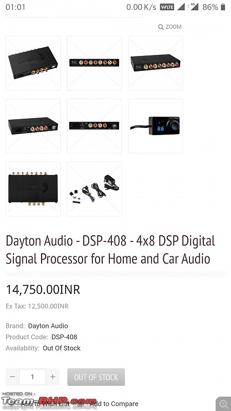

Old 1st April 2020, 01:02   #150
Join Date: Oct 2011
Posts: 12,345
Thanked: 21,452 Times
Re: Upgrading your OEM Car Audio using DSPs (budget version)
How much is the tax on top of it?
18% will be the tax on top of it.
Price updated I think:
Upgrading your OEM Car Audio using DSPs (budget version)-screenshot_20200401010140.jpg
