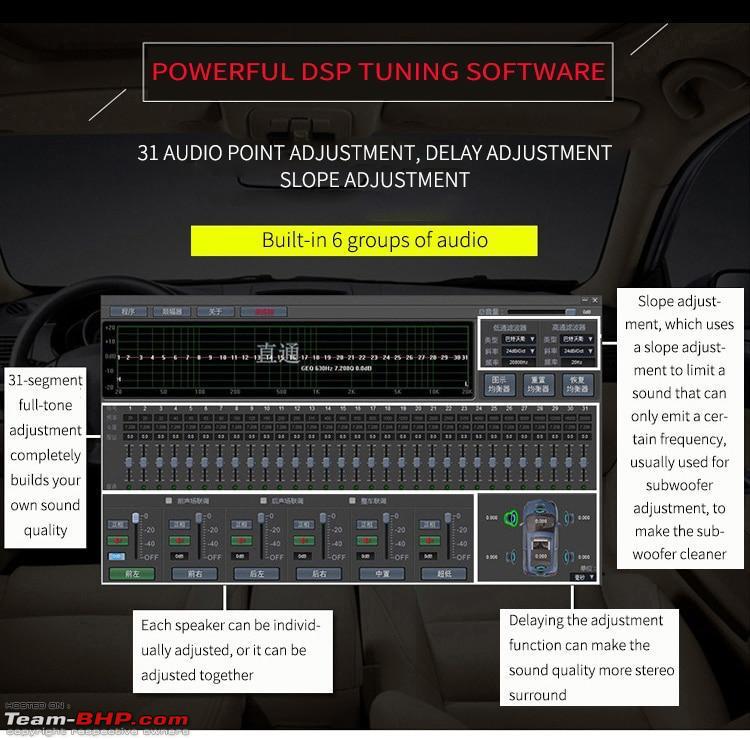

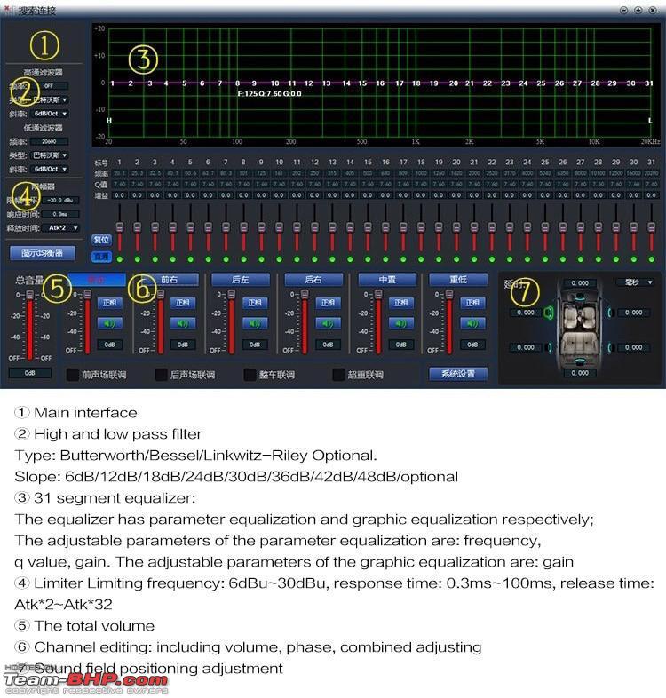

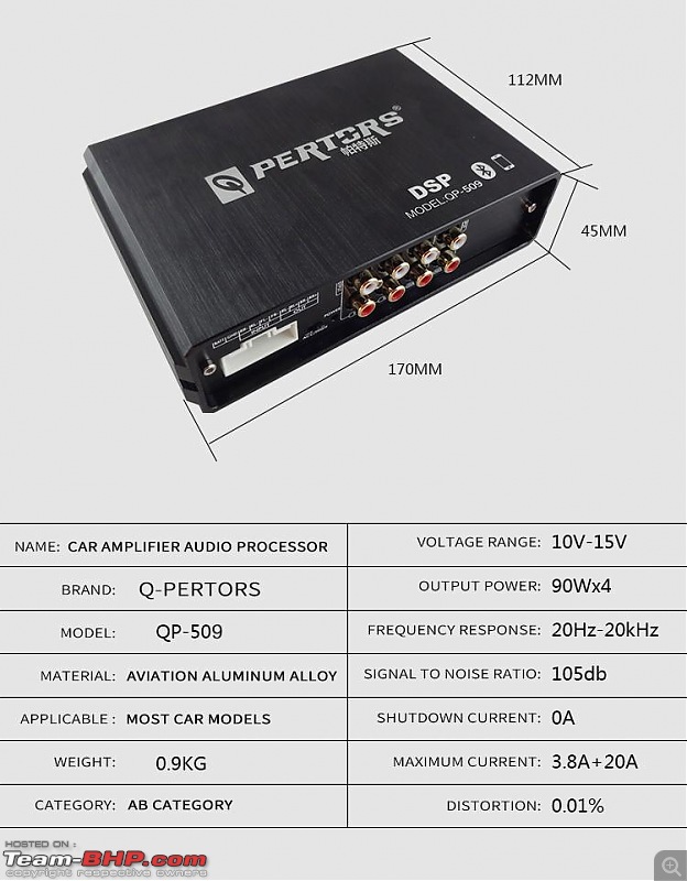

Photos - got it today but not installed as yet

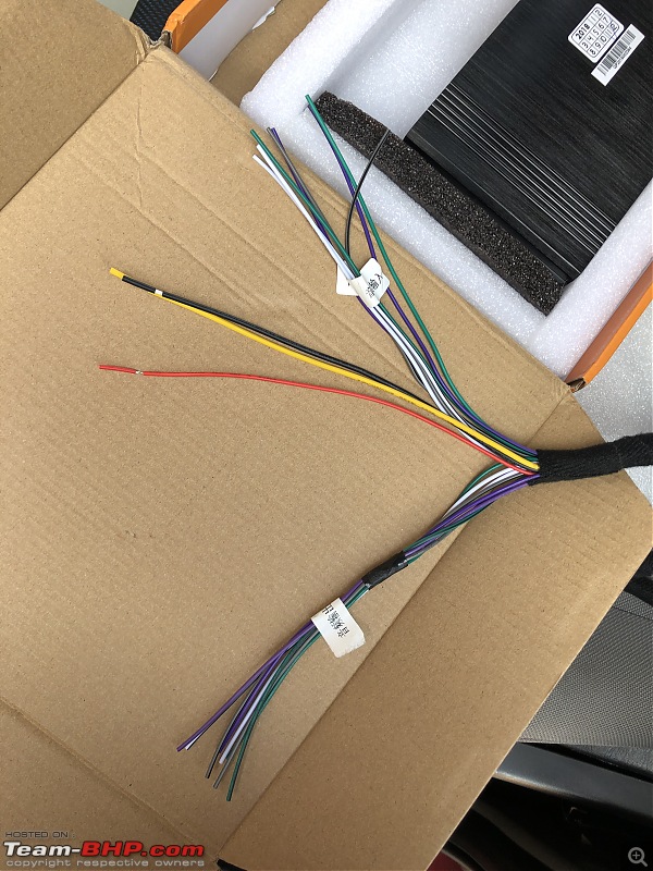

This has bare wires for input, power and output.
Is there a connector available for a 2015 top end Scorpio that will fit these so that I don't have to cut and splice wires? That would void my warranty, which I don't particularly want.
Looks like Scorpio system out - DSP in and DSP out to the speakers.
Is there a connector available for a 2015 top end Scorpio that will fit these so that I don't have to cut and splice wires?.
You can try this. May help you.
It is sold out currently, you can contact Carplus and see if they can help you out.
http://www.carplus.in/mahindra/scorp...-scorpio-13089
