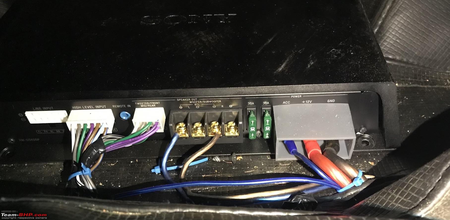

Hello,
To make use of the DSP, I am using the Amp as prescribed by the user manual. I'm not using a Sub as of now, only Comps in front & Ovals at the rear.
I'm facing a hissing sound when connected via the HU, but when I'm directly connected to the Amp by BT, the sound is crystal clear & is pure joy. This might be due to my Scorpio HU not having RCA/pre-out (as gathered from T-BHP forums, I'm a pure noob & very new to ICE ).
Bineet

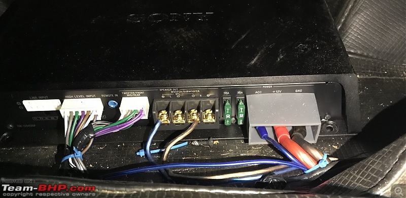

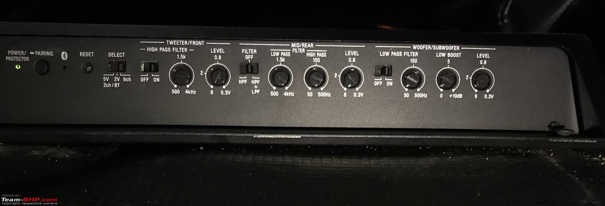

alright I got my ICE setup done for my Brezza, music quality has huge difference compared to stock setup but somehow I am not happy with the output, just do not know why
I am now doubting if the installer knew how to setup & tune the
Sony XM GS6DSP with Morel speakers, I had no intentions of adding a Sub but decided to go for it and Installed a JL 10 inch Sub and the installer setup it up as a 6 Channel amp.
Below is the wiring and settings on the Amp, if someone can verify is this is the correct setup ?
He said I cannot use the DSP since the setup is on 6 channel with Sub being used.
Kanasu is offline

@navin @anubhav22 would you be able to verify & check if the setup is correct
@Bineet_D please share the wiring side picture of your Sony DSP Amp
Hi Kanasu, I was looking at the same amp for my Ecosport and had done some research on the same.
While the wiring looks alright the issue might be something simple like the polarity of one of the speakers being reversed thereby cancelling each other out. Please get this double checked.
Regarding the DSP function. This is the interesting thing. The amp works with the DSP only for 2 input channels not 4 or 6.
On your image you can see a select knob. That is set to 6ch input which means the DSP is off. The DSP only works in 5V or 2V 2ch/BT mode.
The reason is the DSP can accept only 2 channels as input then it distributes it to 4.1 channels (4 speakers + subwoofer). With this you lose the ability to fade front and rear from the head unit.
BAsically from the head unit only the front channel speaker out or line out should go to the amp not all channels. The Amp will then process that input to give you 4 speakers and 1 sub out.
Vid6639 is offline   (4) Thanks
thank you for your response
Now if I decide to retain the Amp as a 6 channel out put and not use the DSP are the settings correct on the Amp, like the High pass filter being On and the other knobs settings ?
The MID/REAR should also have high pass enabled (left position). Currently it is in filter off.
IF you switch the filter off it will send all the low frequencies and will start jarring. Since you have the sub, all lows should go to the sub.
Also the front filter looks like it can go only till 500Hz so it might be better to switch off the HPF and reduce the level knob to see if it helps.
Attachment 1881084

If you are sending 2 channels to the amp and are expecting it to produce 4.1 channels from the 2 channels using the DSP then you have the above limitations.
You should be able to use it in 5 ch. mode with time alignment but with a fixed XO of 50Hz (see 3:17 in the video). I don't know why Sony did this but that's the limitation.
Kanasu,
I understand that you have 4 morel speakers and a JL 10" subwoofer.
In this case you can go for the 4.1 setup used by Bineet.
Why did your installer choose the 6ch. set up?
I understand that in the 4.1 set up your HPF filters will be set via the phone application.

Kanasu,
Yes, I have the below setup with the Sony DSP Amp
Morel Tempo Components
Morem Maximo Coaxial
JL Audio 10W0v3 Subs
As mentioned earlier, towards the end of the installation, I was in doubt if the installer knew the correct way to setup this Amp since it is a versatile Amp.
From the installation wiring pic which I posted above, I am not sure if he has set it up for 4.1 channel (as shown in the manual), I can see he has connected wires to High Level socket & also to Front/med/rear socket, is this correct setup what he has done ?
I have no idea why he chose the 6 Ch setup, will have to go back to him and clarify, I am complete noob in ICE setups :(
should have gone for a better Installer like Anwar (even though on the expensive side)
