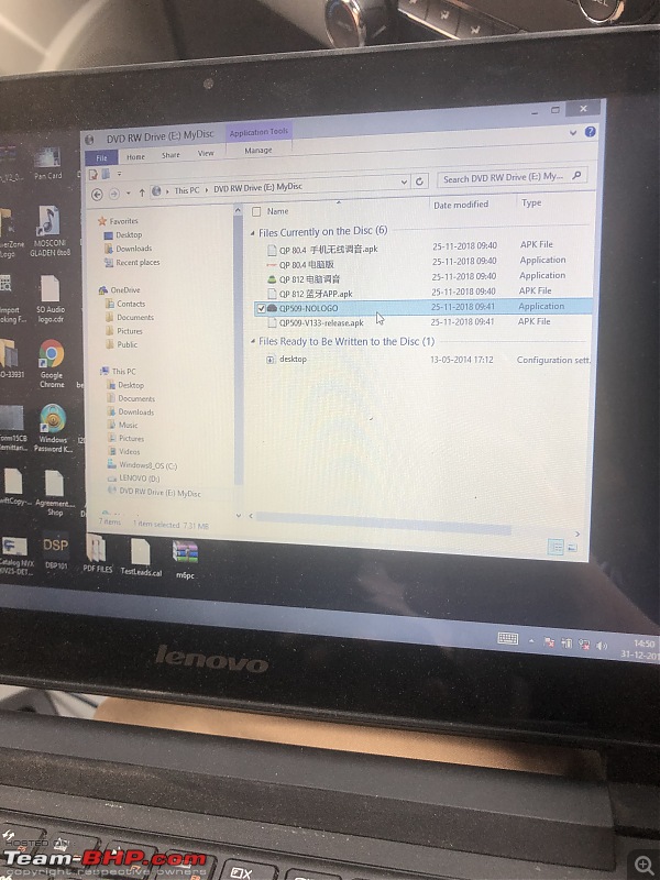

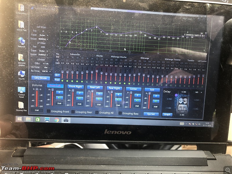

I contacted Saravana Prabhu of Power Zone (1 Whites Road, Chennai opposite the EA mall and you need to approach from General Patters Road due to the one way) and he sourced the harness for Rs 2200, and installed it.
The first challenge was finding which was the input and which the output - it was all labeled in Chinese, but an app called Waygo let me scan the Chinese label and come up with an English translation.
The DSP unit was clamped under the glove box and wiring done after the Scorpio harness was connected to its bare wires. After that it was a simple matter of plug and play into the Scorpio HU, with no wire cutting.
Then a USB cable was connected from the DSP to a laptop and the installation software in the accompanying CD was used to tune the DSP after the Scorpio HU's own equalizer was set to "normal" so it would feed an unaltered signal to the DSP unit.
The tuning was straightforward according to Prabhu, and he was impressed with the features available at $141 on this unit. Some photos of the software which seems to come in Windows and Android versions.

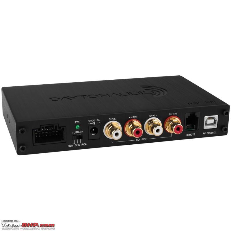

Dayton Audio DSP-408 = 4 input x 8 output DSP for Home and Car Audio
Product Highlights
  • 10 band parametric equalizer per channel
  • High and low shelf EQ per channel
  • Variable crossovers: High/Low/Band-Pass slopes 0-24dB, Linkwitz Riley/Butterworth/Bessel
  • Time delay: 0 to 277 cm or 8.1471 ms adjustable in 1 cm steps
  • Input/Output mixing to customize the signal path
  • Phase adjustment
  • Customizable name/ID for each preset
  • Minimum/maximum voltage protection
  • Load, save, recall, or delete preset files
  • Software controllable level attenuation on the preamp and high-level inputs
  • Reverse voltage protection
  • Mute circuit and delay
SOURCE
