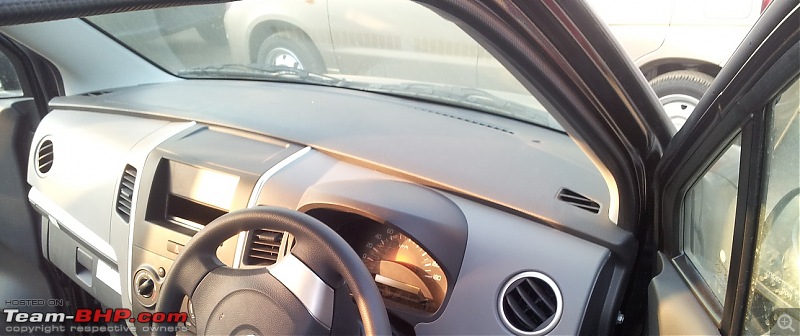

The picture in the earlier thread wont work for my car as i have all glass there , attaching a picture of my car which i went to inspect at the stockyard, installation and damping so much ? that's almost as much as my budget. :P
Don't think i have that kinda money to put there.

The picture in the earlier thread wont work for my car as i have all glass there , attaching a picture of my car which i went to inspect at the stockyard, ...
Kenwood KDC-U349R ...
Oh, it will. A good installer will be able to take a 1/2" MDF piece, cover it fully with grey felt and stick it in that space. This will prevent cutting of the A-pillar cladding.
Oh-oh, there is no OE location on top of the dash for 4" speakers unlike the older W-R. Not sure, but would you be able to take a pic of the door pad and post it here? Just wanted to check if a 6.5" can be fitted on the door.
Better to avoid 4" speakers - they are too tinny for decent listening the way you want. To compensate for complete lack of bass from 4", you will have to put 6x9 on the tray.
But won't there be a compromise with visibility? I think he should retain the glass for better visibility sake.
As it seems that there is no stock location for stock speaker on dashboard in new WagonR so 4 inchers can't be installed here. But 4 inchers are not that bad if they are companied with rear 6" or 6X9" speakers as you are also recommending the same to fix the 6X9 at rear tray. I have experienced Rockford 6.5" coaxials. They produce really good bass, cost around 3-4K and can be used at rear doors if have enough space.

... But won't there be a compromise with visibility? I think he should retain the glass for better visibility sake. ...
If one can't see through the main window in the door, there is not much that will be visible through that tiny triangle. Considering that most cars have that 'sail panel' covered because of the ORVM mounting, that glass area is only an ishtyle statement.

i checked with the maruti guys and they said only a 4" speaker would fit in there, im attaching a picture of the side door of the wagon R, pretty keen on installing the JBL 6.5" components.
Could you show me a picture of what this would turn out like ? I could then show n tell a local technician to see if possible, i believe it would look similar to the picture shared above by another member only it would be a MDF piece covering the entire triangle space ? Correct me if im wrong.
i have some time to decide as my Car is expected on Feb 4th.
Still need to workout the HU selection, something VFM, decent sounding and long lasting.
All of this should fit into 12k, i.e. 6k for the HU.
