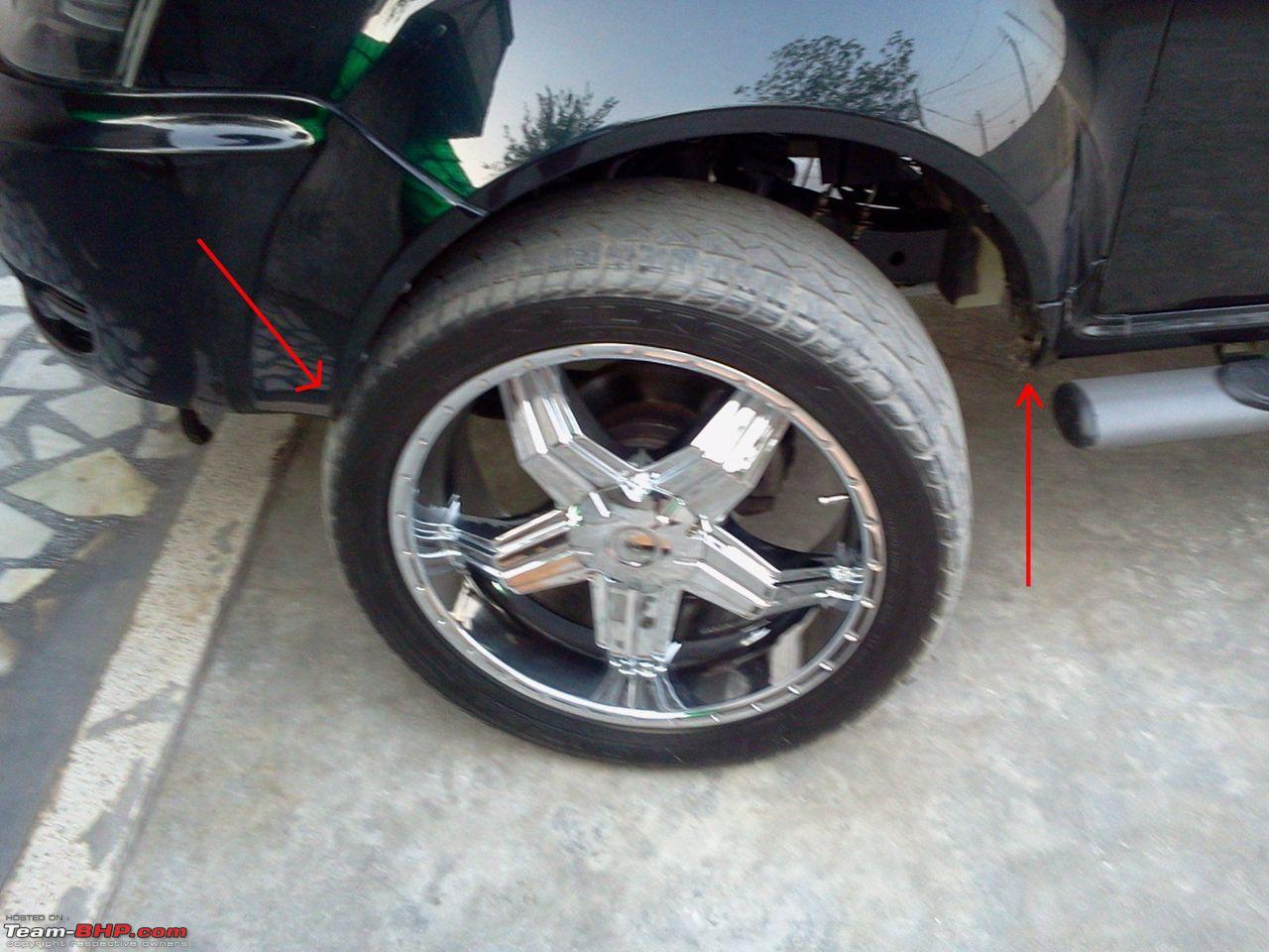

You said 265 mm wide tyres scrape. How about 255? Will it scrape too?
IMO it will scrape if we use high negative offset rim.
See the following pics.
Tata Xenon Crew-Cab launched : The Downgraded variant of Xenon XT-xenon.jpg
chopped fender & more.
Tata Xenon Crew-Cab launched : The Downgraded variant of Xenon XT-xenon2.jpg
Tata Xenon Crew-Cab launched : The Downgraded variant of Xenon XT-xenon3.jpg
Tata Xenon Crew-Cab launched : The Downgraded variant of Xenon XT-xenon4.jpg
& my Xenon XT.
Tata Xenon Crew-Cab launched : The Downgraded variant of Xenon XT-dsc04767.jpg
As you can see the both the width & diameter of the tyre is a limiting factor in Xenon.
Stock size of the xenon is 205/80/16 .:Frustrati
So (IMO) with zero offset rims you can put 265/65/17. (ex. TurboDiesel's xenon)
& with high negative offset you can only use tyre with 26"~27" of overall diameter.

205? I think stock width is 235 mm. I mean for XT. If underpinnings of XT and the commercial crew-cab are same then , 235 can be fitted onto crew-cab. BTW, which is better thing-- fitting 255/265 width on zero off-set rim OR stock 235 mm on negative-offset rim. I don't want to talk about rim size and side profile because the sum total of side profile and rim size has to be kept closest to stock overall wheel dia.
The last pic Xenon looks great. Too bad if this combo scrapes, too.
