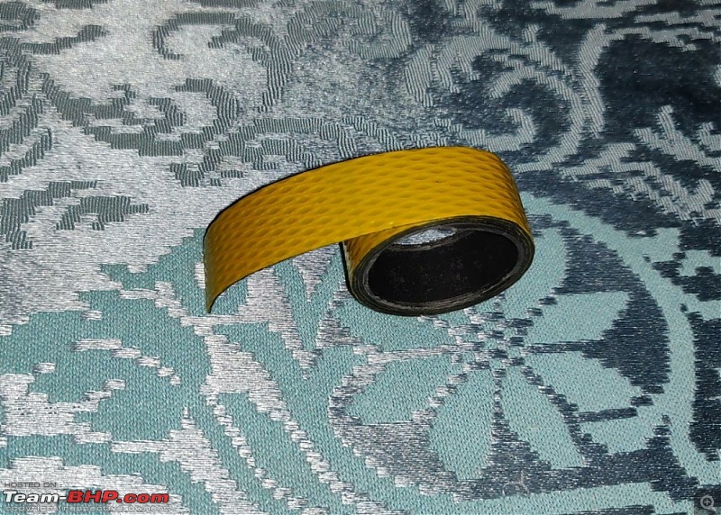

Originally Posted by Drbhavesh View Post
Won't the glue of the tape will cause corrosive effecr in long term?
Hasn't happened since over 1 year with respect to fog lamps. Although I don't have a picture of it covered right now. Will post it when I open up the bumper.
Do you mind posting a picture of the electric tape and how you wrapped it around connectors?
DIY Install: 3" XP Micro Bi-Xenon Foglight Projectors on my Swift-screenshot_20200428183259__01.jpg
DIY Install: 3" XP Micro Bi-Xenon Foglight Projectors on my Swift-screenshot_20200428183305__01.jpg
This is the tape. The yellow plastic needs to be removed before application. You have to stretch the rubber and keep applying, it adheres to itself and then forms some kind of seal with itself. It's the same one used in submersible pumps which stays always underwater.
