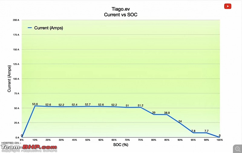

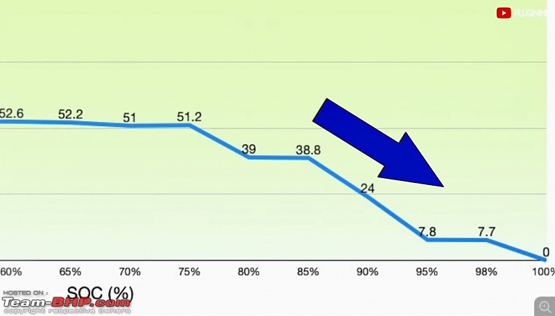

The above link by team Plug in india provides the data from charging test of the Tata Tiago.ev.
Link :
