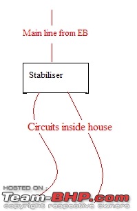

From what I have seen it requires very little rewiring as you do everything where your main supply enters the house. The big stabiliser is placed here and then this gives supply to the old circuits via a fusebox (or one fuse as I saw at one house :)). So the old prewired circuits stay intact all the work (couple of wires) are placed near the head of the circuits. Not sure about the cities but in villages the EB do not bother about these large stabilisers.
This very basic diagram sums it up.
@ Bigman, Thats correct, your diagram says it all
clap:
and EB does not bother about large stabilisers in cities as well. The increase in power bills and your correct payments are sufficient for them not to bother you.
