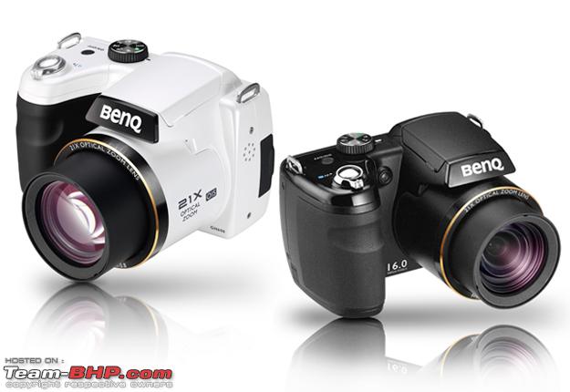

Another one joins the war!
http://www.wretch.cc/blog/WCHUAN99/1809045
http://benq.co.in/product/dsc/gh600
