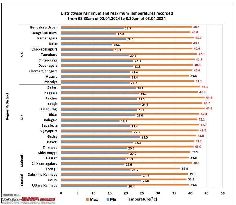

You can try air coolers. Since humidity is on the lower side, it will most likely work as an alternative to AC. Keep atleast one window open in whichever room you run the cooler.
Originally Posted by subraiyr View Post
On the note of air conditioners and air coolers - this came across in our community. User @Lazy said 37 is the temperature in Bangalore. Seems now that we have a scorcher summer in Bangalore. This was published by Karnataka State Natural Disaster Monitoring Center publishes yesterday's temperature in Karnataka - Bengaluru shows 40 degrees C!
Attachment 2590273
Originally Posted by Gansan View Post
Try air cooler. They can be effective in non coastal areas and are popular in Delhi, Hyderabad etc. But you can achieve only about 2-3 degrees below ambient temperature, no more.
Originally Posted by It's Magic View Post
You can try air cooler as others have suggested.
We had these coolers some time back, and my observation was that they start making a lot of noise as they get older.
Originally Posted by tj123 View Post
Do remember that water coolers guzzle loads of water (atleast the old models), and since Bangalore is facing a water crisis, it may not work for all.
That is a personal cooler, you will have to sit right in front of it! What you need is something like this or even bigger:
https://shop.symphonylimited.com/pro...UaAqUIEALw_wcB
So, last week during a short visit to Delhi, took the opportunity to see an installation of a ducted evaporative air cooler - a dentist's clinic, no less.
Outside temp was hovering at 41 C (per my car's gauge), and inside it was really cool, say about 28 C. They had covered up their three split ACs and they are used in monsoons. Otherwise, during summers the cooler is primarily used.
Happy with the cooling, air speed, noise, low running costs & most of all the environmental load (less electricity, no refrigerants).
Now the catch is the spend & suitability to Bangalore's weather.
Spend:
Price is about 1.2L + ducting/vents + plywood/laminates works to cover the internal ducts and casing for the vents.
This will work for 4 medium sized rooms.
Suitability:
While steep, am okay for the above spend, but need more validation on suitability for Bangalore's weather.
Here we see over 5-6 months of high humidity, when this cooler will reduce temp by 4 C from ambient. In current dry summers, it'll bring down by 12 - 15 C.
Getting confused, for about 1.6L, we can easily get 4 split units and be assured of the performance.
cheers
