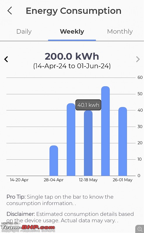

In fact I've recently purchased another Panasonic for the living area. It's a 2 ton 4 star inverter model but the cost difference between 4 and 3 star model in my case was around 2k rupees, so it was a no-brainer. The installation is scheduled for this Friday so I will post an update later on its performance.
It's been a month since I got the Panasonic 2 ton unit. Here's my experience:
1. Noise levels are acceptable at LO/MED fan speeds. There is another quieter setting below LO at which the blower is barely audible. But it's not usable as the cooling rate drops in some time. I usually keep the fan speed on Auto and it seems to switch between LO and MED speeds from time to time.
2. Cooling levels are average for a room size of 15x20 ft. Room gets no direct light but heat from terrace. Outside temperature peaks at around 44-45 degrees during the day. The outdoor unit distance is within 3 meters. The AC takes around 15-20 minutes to cool the area directly in front and almost 1 hour for the entire room. Having app connectivity helps as I can remotely switch on the AC well before I step in the room. There is a powerful mode for faster cooling but I haven't tried it yet. Good thing is that once the set temperature is reached, the unit works well to maintain it. There are no "too cold" moments, a major issue with our non-inverter units.
3. App connectivity is seamless. All settings can be controlled on the phone, including convertible modes, timer, usage profiles etc. The app shows filter health (no percentage) and energy consumption as well. Since April 30, I have consumed 200 kWh which translates to a daily average of 7 kWh. The usage is around 5-7 hours a day at 26 degrees (mostly) and Auto mode. I believe energy consumption is on the lower side for its tonnage, members can correct me if I'm wrong.
The home / office air-conditioner thread-20240530-11.38.36.jpeg
4. It comes with plenty of features. Some gimmicky, some useful. There is a horizontal air direction mode which I found to be very useful. Seven convertible modes can be used to limit the AC's working capacity and save electricity. It's a different thing that cooling starts to suffer at second lowest (55% mode) and is inadequate at lowest (40% mode) setting. Then there is a clean mode to clean the insides of the AC (well that's what I was told ) but I'm yet to try that.
5. Build quality isn't the best. Both the indoor and outdoor units are surprisingly compact and light. While the outdoor unit is alright in terms of quality levels, the indoor unit is quite disappointing. There is a sizeable panel gap at the front just above the air vents. The front cover panel also feels flimsy and low-grade. Quality has definitely taken a dip as compared to our older (and 40% cheaper) Panasonic unit. Remote is of acceptable quality with a white backlit display, no complaints here.
Overall, I would rate it 3.5/5. Cooling and build quality isn't exceptional but the AC scores high on convenience with a good list of usable features and app connectivity. It costed me around 52k after exchanging my old non-working AC. This price includes installation and a swanky V Guard voltage stabilizer, which I think was an unnecessary expense. Hope this information will help others in decision making.
