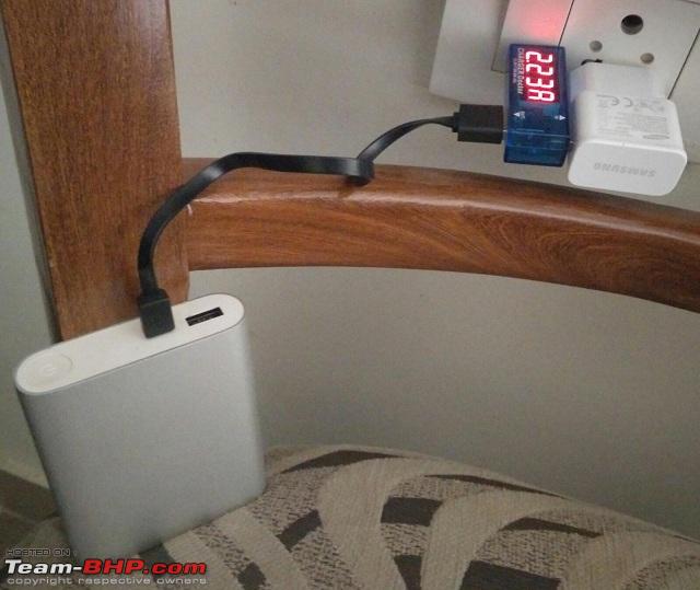

I use a couple of USB charger doctors to monitor charging, my Oneplus One is very temperamental and charges at 1.83A when its only between 25-75% battery. 75-90 its 1A and above is limited to 0.64A. Very useful tool to diagnose what is wrong with charging. My Mi 10400mAH power charges faster than its rated for and I couldn't be happier!

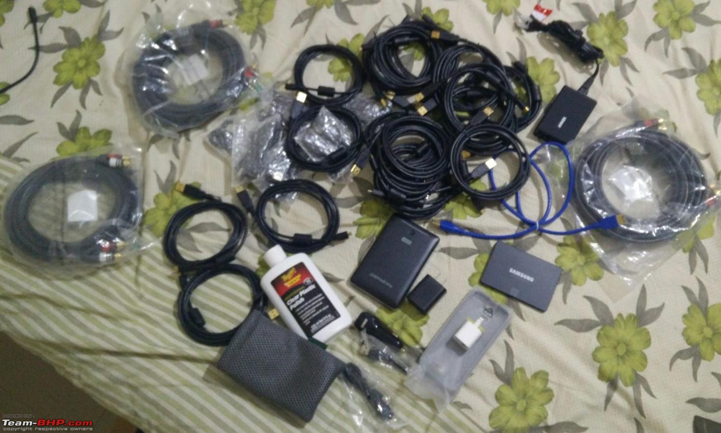

For the guys interested in QC 2.0, the cables need power lines having 20AWG wires.
PS : I've suffered enough of low quality USB cables and I got a friend to get me 3 dozens of awesome USB cables from USA clap: not to mention anker/ravpower 40W charging stations for home, 2x2A chargers for the car and so on. I'm all set as far as cables and chargers go hehe.
