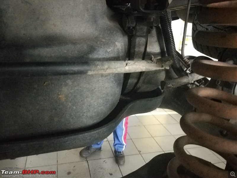

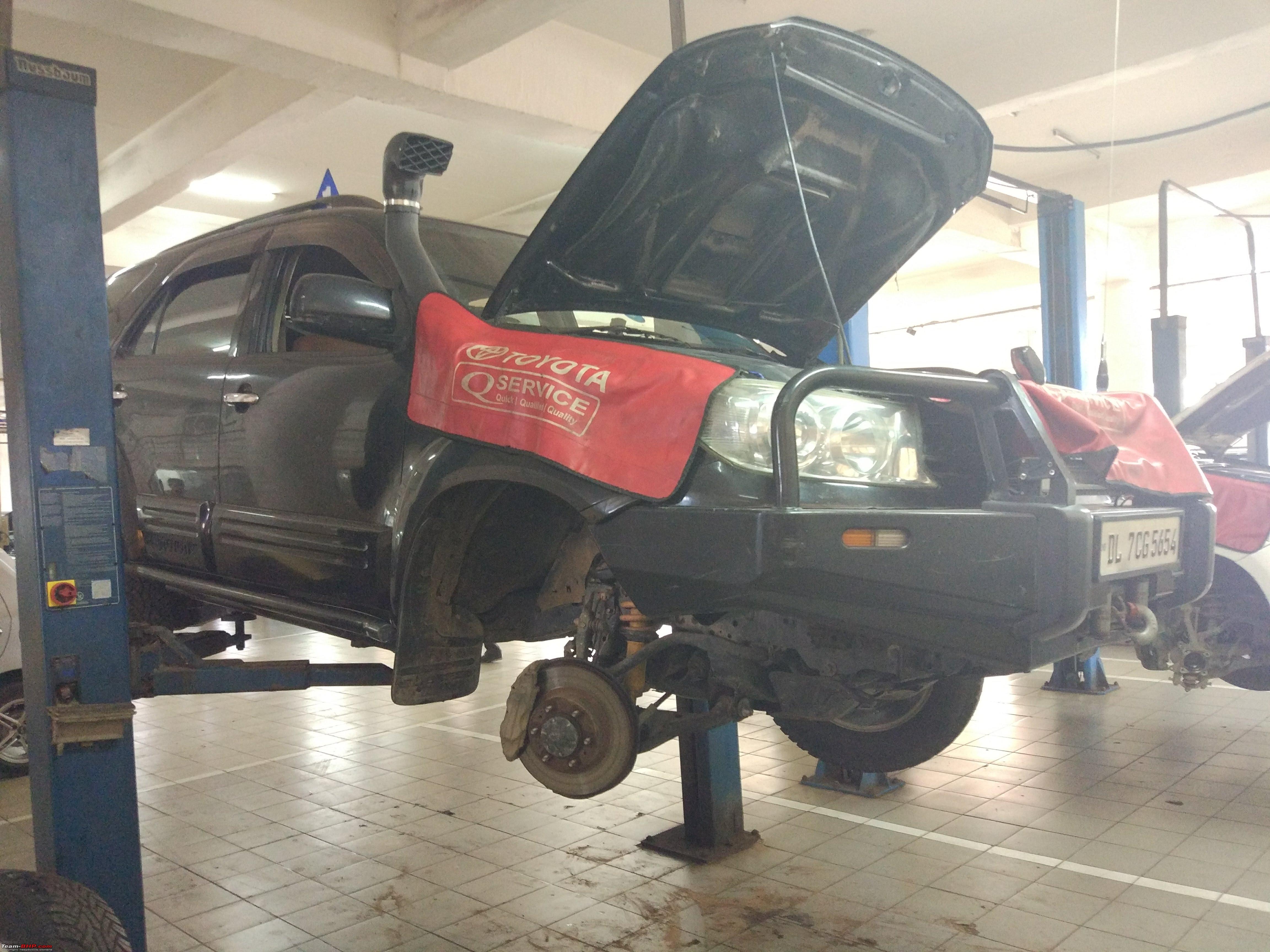

I will start the update with a little grudge and frustration I have been carrying against Toyota. As you all know, I have been sending my truck to Toyota for regular maintenance and repairs (if any) and my experience has been great overall. However, I happened to have found a problem unique to my generation of Fortuners. The link rod in four-link rear suspension of my vehicle gives up every now and then. I found out this is a known issue with Fortuners in South Africa, however I don't seem to find this anywhere reported in India. In fact, I have seen Toyota mechanics scratching their heads and asking me repeatedly how this rod was broken, because apparently across all the dealerships I have been to, none of the dealerships have had to replace this component. But MGF Toyota Gurgaon, has put in 3 rods in my truck in 2017 year itself! Go figure!!!
During recent service of 210k kms.

Broken piece of linkage rod.
My Pre-Worshipped Toyota Fortuner 3.0L 4x4 MT - 225,000 km crunched. EDIT: Sold!-3.jpg
The placement of rod in rear suspension (for better visualization)
My Pre-Worshipped Toyota Fortuner 3.0L 4x4 MT - 225,000 km crunched. EDIT: Sold!-link-rod.jpg
Link to a South African Thread on this topic
As per my understanding, this linkage rod breaks when Fortuner's rear suspension bottoms out or is pressed inside the wheelwell at its maximum articulation levels (which has been the case with me because of all that offroad I do). The spare part by itself isn't really cheap at INR 6k, considering it is a simple steel rod needed to prevent any movement of rear axle in the direction of moving wheels (kind of a stabilizer rod, if I can call it that). My complain to Toyota is, this component should not give up like this. Anyway, if it gives up on me again, I will have to go South African way to replace it next time and get one fabricated (with thicker piping but rest all specs remaining same) for myself.

However, as I see it in short term, the replacement of the suspension rod and next set of mods (including ARB Air Locker in rear) may not happen for a few months at least because I am temporarily relocated to Mumbai for work 3 weeks back, and will think about getting the car here once I settle down. Honestly, with Mumbai's traffic in mind + possible issues with cops on a DL registered car with so many mods (bullbar etc), I think it will be prudent not to relocate the car immediately; although on a lighter note, Mumbai seems to be an ideal city for my car, full of craters offroading all the time + Mumbai monsoons can make good use of snorkel too!

Great to see Atlantis munching up miles rather nicely. Regarding the link rod issue I hope Toyota rectified the issue in later fortuners (I have a 2013 car) as its very unlike Toyota to have a mechanical part fail again and again. Loved the pictures of the spiti snow drive you posted and videos by Anshuman.
