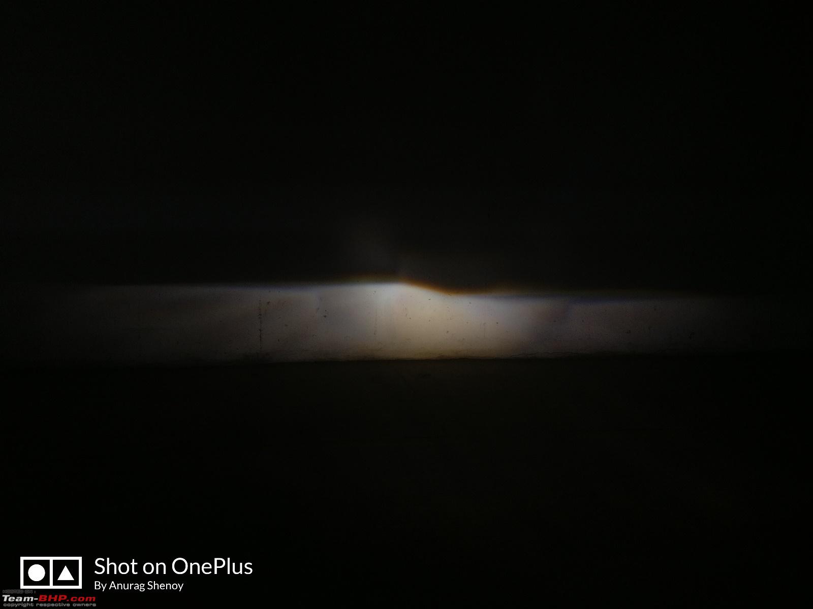

Adding some images too that I captured against the white wall.
Low beam
Hyundai Creta 1.6L CRDi SX(O) - An Ownership Log - Update: 1,00,000 km up!-img_20180714_104715.jpg
Low beam zoomed (manual mode)
Hyundai Creta 1.6L CRDi SX(O) - An Ownership Log - Update: 1,00,000 km up!-img_20180714_104447.jpg
LHS - Low beam
Hyundai Creta 1.6L CRDi SX(O) - An Ownership Log - Update: 1,00,000 km up!-img_20180714_104702.jpg
RHS - Low Beam
Hyundai Creta 1.6L CRDi SX(O) - An Ownership Log - Update: 1,00,000 km up!-img_20180714_104710.jpg

After a gap of roughly 3 hours, here's another video that shows the time required for the HID to reach it's full brightness. Roughly needs 35 seconds.
Have you installed HID's for the fog as well? How come I saw two flashes during startup? Is there a delay? That shouldn't happen right.
No. Fogs are LED.
Yes there was a delay in the left one firing up in the video. Hasn't happened again (even yesterday night when I return from work). Will check again today when I leave for work.
