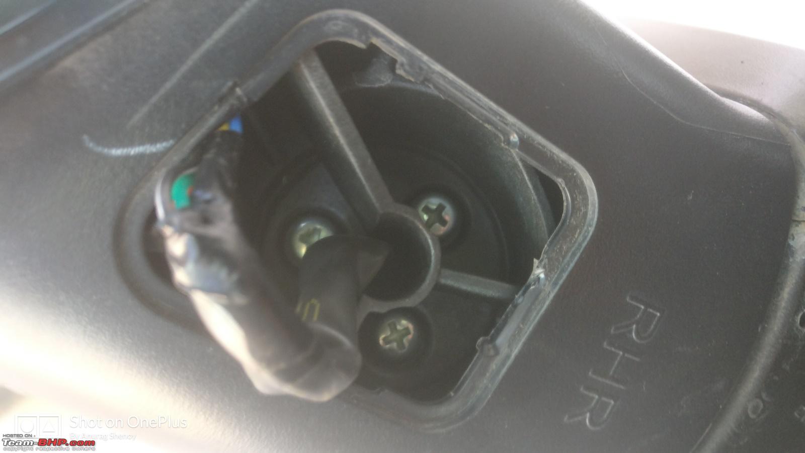

  • Using the trim panel removal tool, remove the tweeters;
  • Using the 10mm socket, remove the 3 nuts holding the ORVM in place and pry it out;
  • Hold the ORVM glass at the base and pull it outwards to free it from the mount;
  • Turn the ORVM unit upside down and remove the cap at the base to pass the wiring;

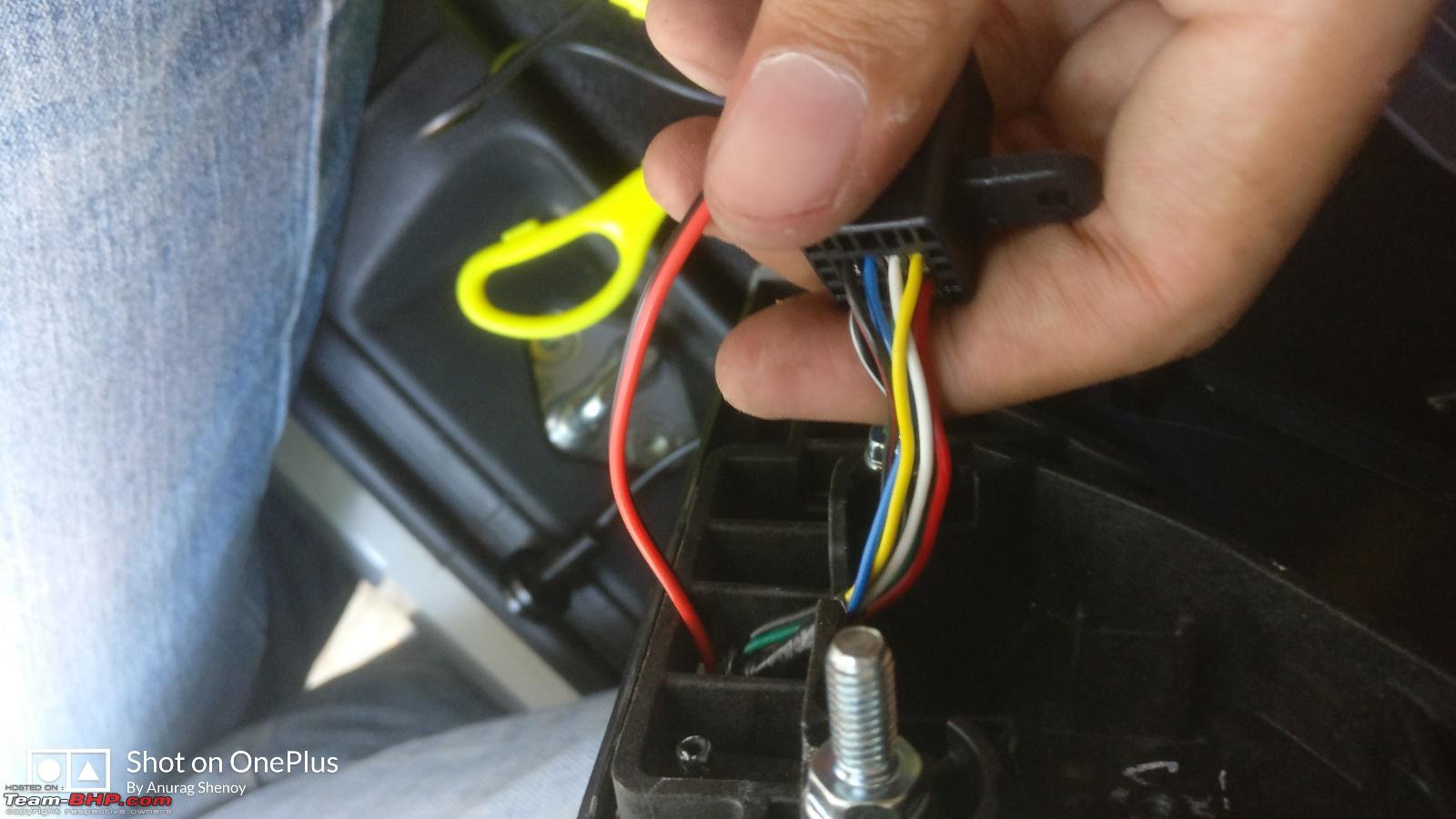

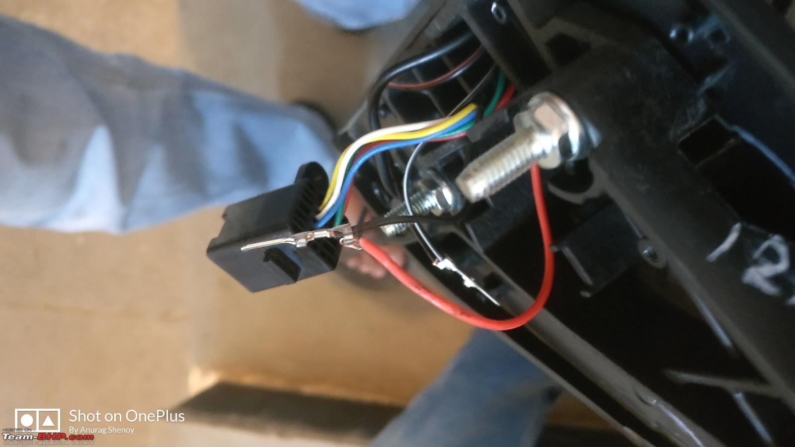

  • Pass the wiring from where the other wiring loom has been passed and get the free ends near the main ORVM wiring coupler;
  • De-pin the two wires that connect to the LED indicator on the ORVM
  • Solder the respective wires and re-fit the pins in the correct location
  • Refit the cap that was removed in the earlier step;
  • Fit the ORVM glass and mount the ORVM back
  • Fit the Tweeter
Wiring to be used to power the LED Arrow Indicators (as seen on the main ORVM coupler)
  • Black+Red = Positive wire
  • Black+White = Negative wire

De-pin the +ve wire from coupler and solder the red wire of the LED arrow on the pin and refit the pin into the coupler
Hyundai Creta 1.6L CRDi SX(O) - An Ownership Log - Update: 1,00,000 km up!-13.-positive-wire-depin-red-wire-soldered.jpg
De-pin the -ve wire from coupler and solder the black wire of the LED arrow on the pin and refit the pin into the coupler
Hyundai Creta 1.6L CRDi SX(O) - An Ownership Log - Update: 1,00,000 km up!-14-negative-wire-depin-black-wire-soldered.jpg

MODIFICATION #6: DIY Headlight Bulb upgrade (Minor one) from Sylvania to Philips Xtreme Vision
Coming from a 100/90W + 35W XP Micro (bi-xenon projector) combination setup to a 60W halogen projector + 27W fog lamp combination, it was difficult for me in the initial days to adjust to the lighting output but now it is okay since I'm getting used to it but not of much help while travelling at highway speeds on our national highways. I don't blame the projectors on the Creta since they are one of the best light outputs I have seen from the factory.
Only bulbs that were available were the Philips Xtreme Vision on Amazon.in. Here's the link
I got the bulbs from the distributor here in Hyderabad for ₹ 600 x 2 = ₹1,200.
Difference in lighting output (read brightness) is negligible as the Sylvania's are of 60W and the Philips XV are 65W, a bump by just 5W. Only difference that I could notice with the Phillips bulbs were the cut-off lines are a bit more sharper than the OEM Sylvania's.
