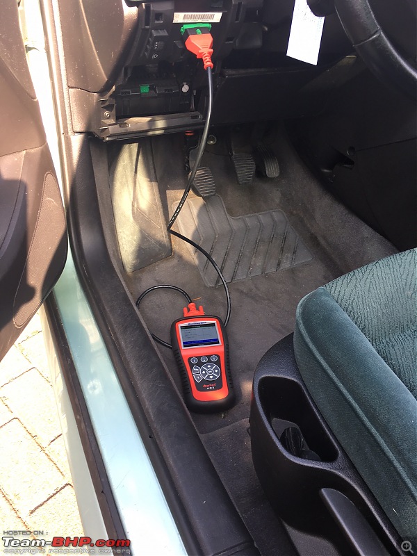

Old 22nd October 2017, 12:31   #835
Posts: 8,937
Thanked: 61,912 Times
re: My Ford Fiesta 1.6 SXI completes 13.7 years and dies by drowning!
Originally Posted by vnabhi View Post
But how does one reset the error? Any special tool needed for that?
Thanks, there are two ways about it.
You could just simply disconnect the battery and reconnect after thirty seconds. That might already do the trick. Especially on older cars
If not, then you need a special tool, a so called OBD (on board diagnostic) analyser or scanner with a reset function.
Here is mine in action on my neighbour’s Peugeot 307.
My Ford Fiesta 1.6 SXI completes 13.7 years and dies by drowning!-img_1519.jpg
Have a look here for some more info on my OBD scanner:
http://www.team-bhp.com/forum/techni...ml#post4161599
And here are some jobs I have been using this one (and another PC based OBD analyser on some of the jobs I’ve done recently)
There are a few threads on OBD on the forum. There are simple version that run as an app of your smart phone. I don’t know if those have re-set functions. Probably not.
http://www.team-bhp.com/forum/diy-do...eo-spider.html
