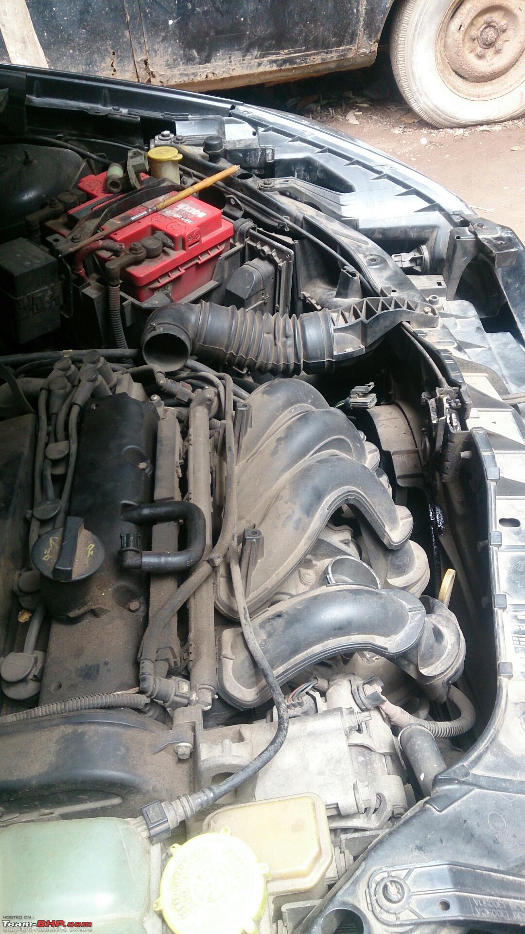

Hi guys, I'm have not really had the need to post before in the non vintage and classic car section prior to this but I've had a recent problem with my car so need help.
I own a 2007 Ford Fiesta 1.6 SXI (non ABS) Duratec petrol. The following happened yesterday, while driving back home from work:
- the ac stopped cooling gradually
- the temp meter needle started climbing very fast and went to full red
- the engine was running so hot that the coolant boiled over and
steamed/gushed out from the coolant tank cover onto the road.
I switched the ignition off and pushed the car to the side of the road awaiting my mechanic. After topping up with water, we saw that there are no leaks in the cooling hoses. Resumed our journey with ac on and the ac started cooling normally. After 20 min, the ac stopped cooling again and the temp needle started rising rapidly with coolant boiling over etc. Parked in a side-lane and we then realised that the radiator fan is coming on erratically. Although the engine was so hot, it wasn't running. Only when we put the ac switch on, the fan eventually started but then after a while it stopped and the coolant started boiling over again.
So we decided to cool down the engine completely, topped up water and then without the ac, drove back home with the temp need at the normal halfway mark through the remaining 20 min back home.
Now my question is, what could be the possible problems? We are guessing that the fan switch or resistor would be the culprit since it seems that the erratic working of the fan is causing the problems i.e. it's not cooling down the engine as its not coming on when its supposed to.
I don't unnecessarily want to take the car to the ford a.s.c. in Kolkata since I had a bad experience with them the last time and their policy is replace en mass without diagnosing.
We've opened the radiator fan sensor switch today and think its the culprit.
Also some photos of the part that we've opened and some of the engine area (head cover opened) in case any of you have pointers on what else may be causing the faulty fan function. I'm clueless on the location of sensors on newer cars so if something else should be checked, please highlight it in the photo.
Thanks in advance,

I think it's the thermostat at fault. Have your fng remove it. The fan should stay on constantly. If that is the case, then a replacement thermostat will be around 1k. It's easily accessible, removable and putable (?)

@MBZ--Sorry for the delayed response, but I guess it could be a malfunctioning AC fan motor. I had the same issue when the car was 2.5 years old. It was replaced under EW, else would have costed around 4500 INR.
