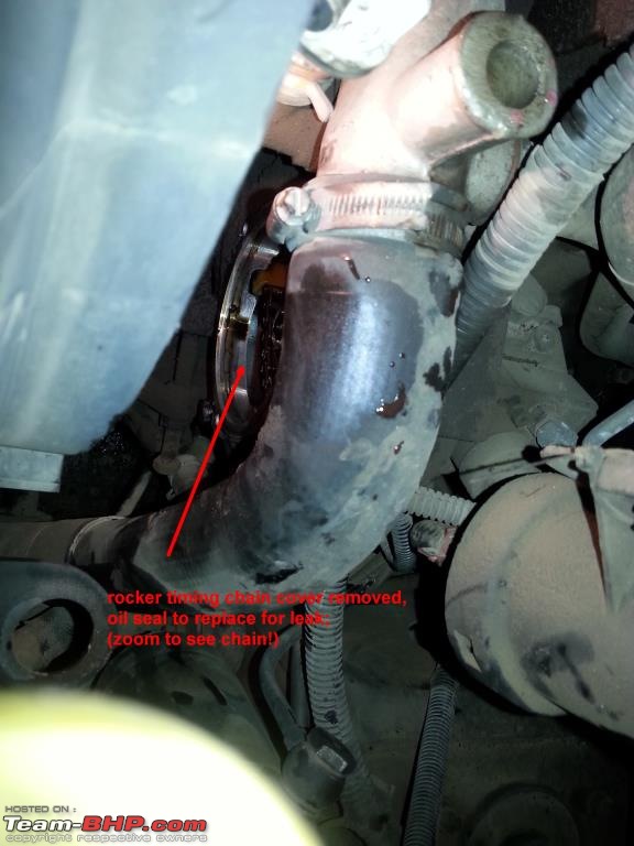

Service Update: 88500 KM
The main reason for my visit was Engine Oil change, suspect of bad UJ bearing (propeller shaft), some oil leaks, etc.
Actual works done:
- engine oil and oil filter change (I have always used the OEM, now FEO variant)
- Two of UJ had developed play and were replaced. some info I put at http://www.team-bhp.com/forum/long-t...ml#post3386819 for ref
- Front Brake Pads were replaced. this time, discs were skimmed on lathe machine. some updated put at http://www.team-bhp.com/forum/techni...ml#post3360359
- during the brake cleaning exercise, the engineer noticed a small leak in Rear Right Differential Axle, oil seals (inner & outer ones) were changed.
- power steering hose was anyways leak, and replaced this time. PS Oil was also renewed.
- breather hose assembly had a leak, replaced along with its seal
- a leak was found on the rocker cover (housing the timing belt), seal & gasket was changed
- tappet gasket was replaced, had a leak. Few month back also I had got it changed !
- after my last service (@ 82K KM), I had a successful trip to Kutch (sorry again lazy for no TL!). The engineer suggested that because of dirty air filter also, there are changes that breather pipe was getting leak. So, we opened air filter compartment, and indeed the filter was dirty - maybe because of the dusty environments I traveled. Air Filter was also changed.
Now, actually I had already ordered the air filter from ArrowHead Filters (costing same around 750), and was awaiting delivery. But above process forced me to change to OEM one at workshop itself. The AHF was delivered few days later.
I noticed that OEM one has a oil film to trap the dust; whereas the AHF one doesnt have any oil. Its just dry. I checked with AHF guy and got a reply that they maintain the porousness (holes) using multiple layers of foam type, and hence oil wasnt necessary. Infact I asked him whether I can store it as spare for long time, he said perfectly fine to keep it sealed and use when needed.
- I mentioned to engineer, that sometimes the Reverse Gear was getting stuck. Engineer suggested to replace the Detent & Plunger Kit. Its basically under the gearbox, having a ball-bearing put on a spring, housed in a slot, screwed underneath. All costs below Rs.150.
Total Bill was Rs.14500/-
Below some pictures of above story:

- few days back, got replaced the engine mountings (were torn-off!) and gear-box mountings.
- a bit diff oil was leaking, so got inner oil seals on both rear axle (see previous post of earlier change)
