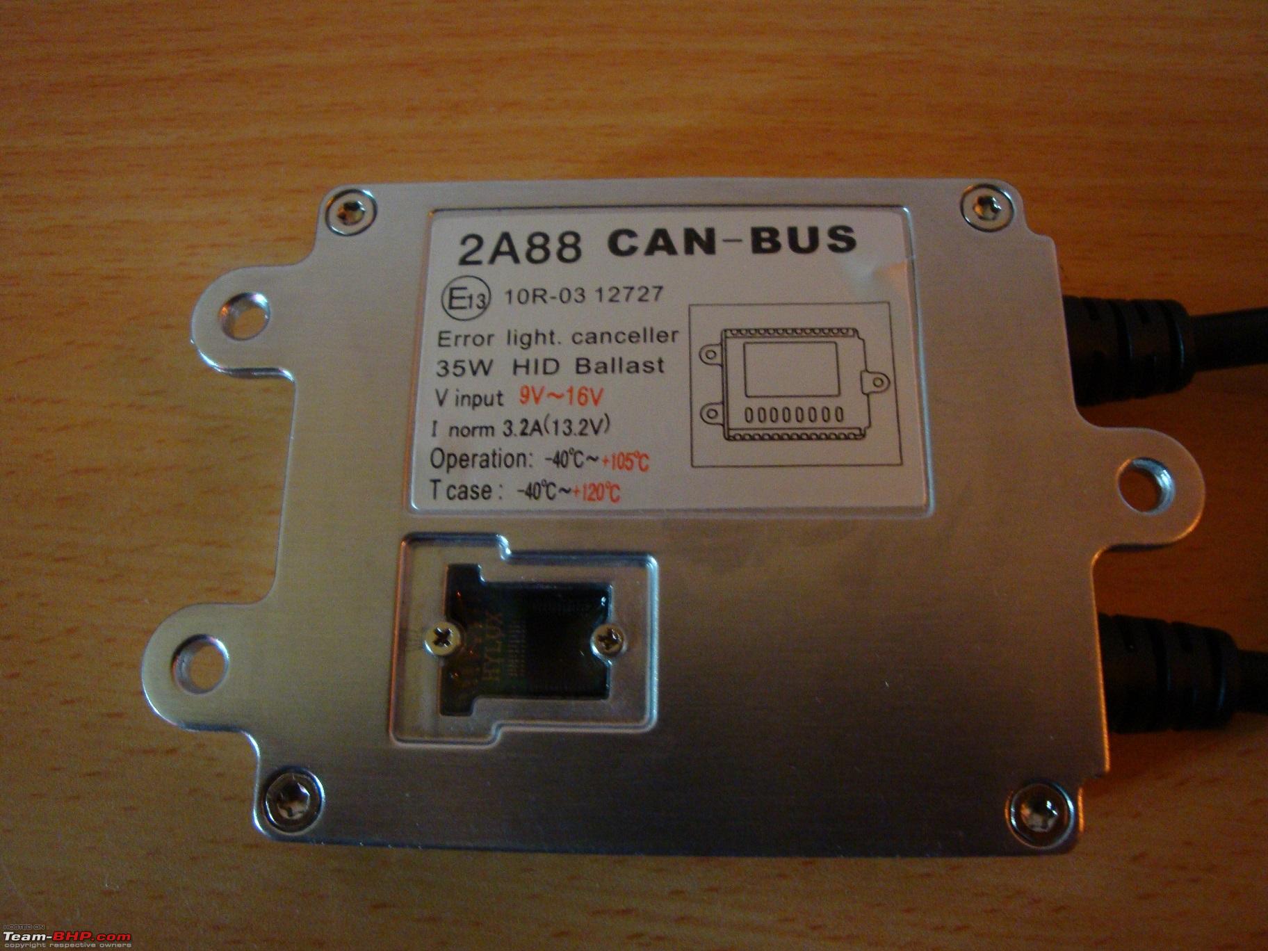

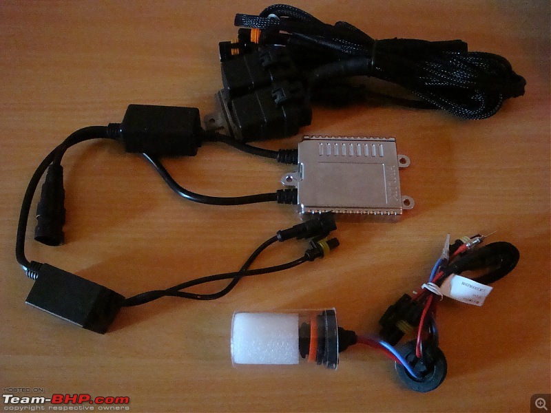

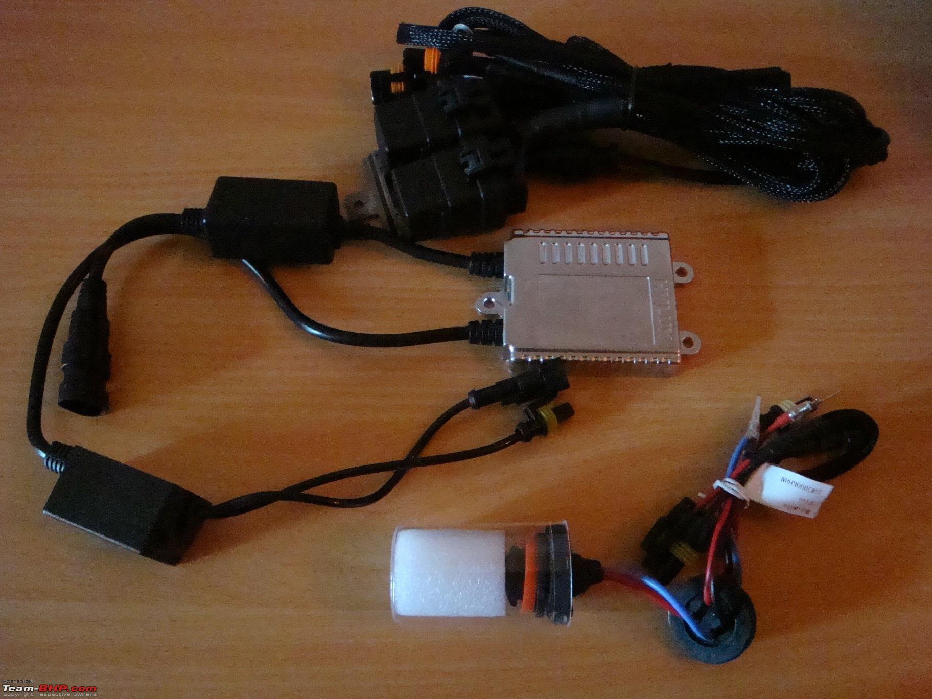

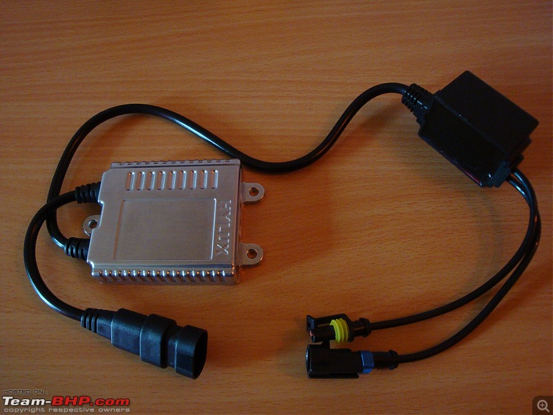

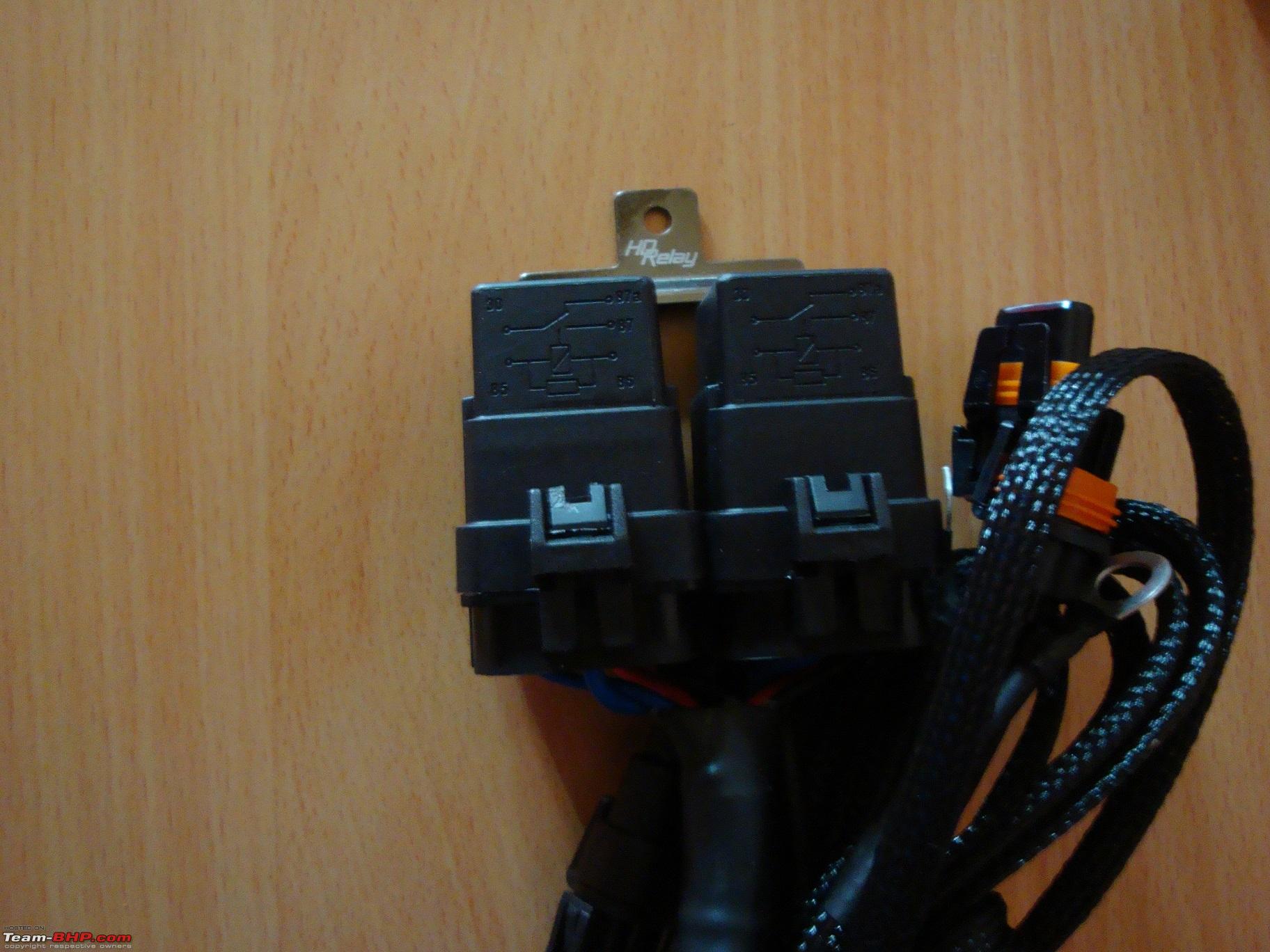

Old 10th September 2014, 09:33   #180
prince85's Avatar
Join Date: Sep 2005
Posts: 971
Thanked: 122 Times
Re: Best Xenon HID conversion kit
Originally Posted by straight6 View Post
I'm looking for H8 3000k HID kit for my fogs. Any idea if they are available here?
I have been using 3000k HIDs for the fog lamps in my SX4 since a while now. Was scouting for extreme quality stuff and hence got the HID bulbs from the TRS Distributor (AVS Tuning) in Mumbai. The said bulbs are Morimoto 35w H8. I also got the H8 Morimoto HD Relay Harness which is an optional bit of kit for H8 hid lamps (not a compulsion to use the same), but kind of adds to the safety and performance aspect with built in cube relays and inline protection fuses. Though they also sell extremely good quality high end Digital ASIC Ballasts, i decided to go a step further and order the best possible after-market ballasts from Hyluxtek and hence ordered for their top of the line HYLUX ASIC 2A88 Digital Ballasts.
Hope it helps.
