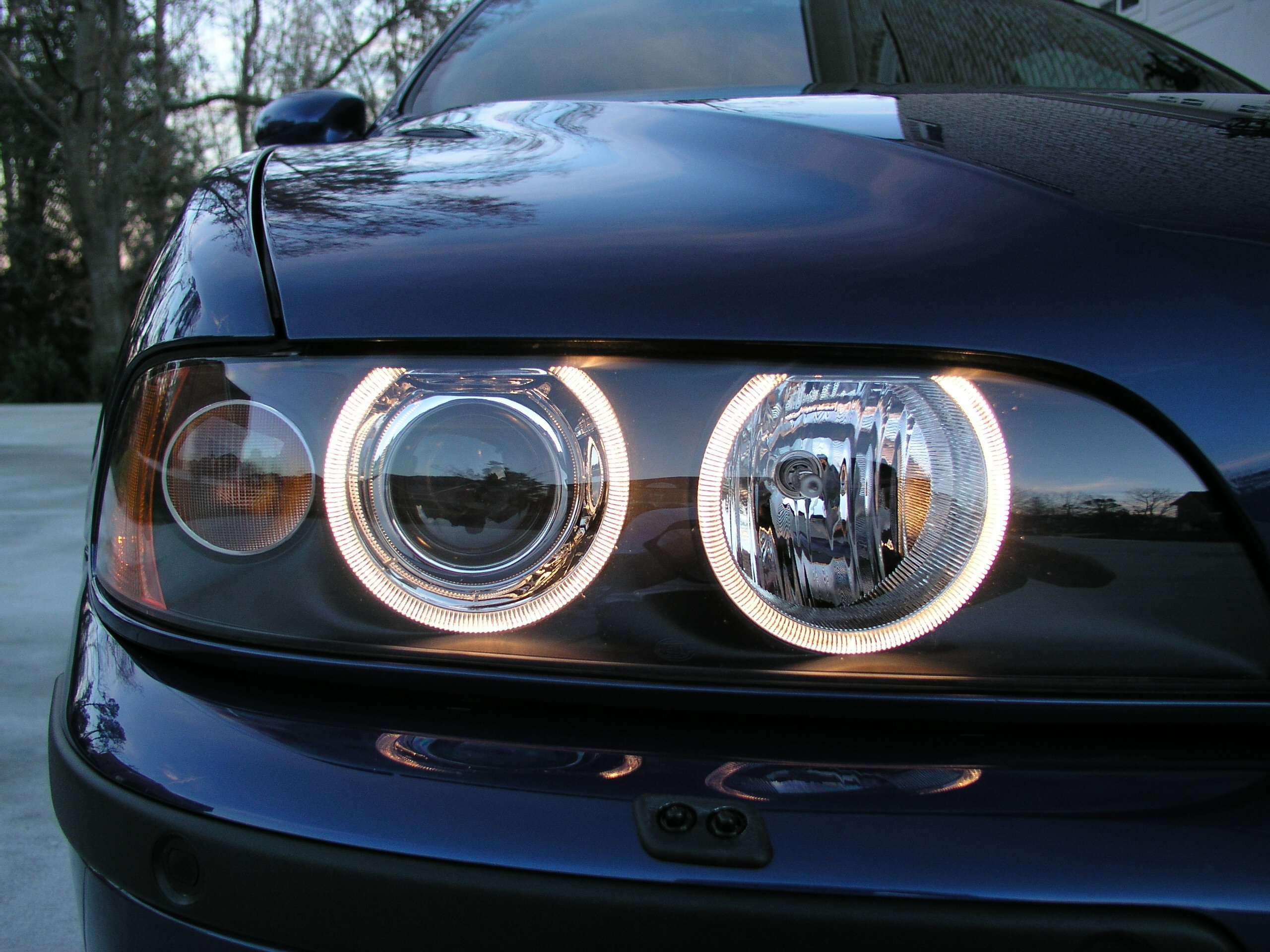

I too want to do the same with my Black Scorpio GLx HLs. Where is this done and the cost. I ahve Philips Crystalvison 55/60 tubes and don't want reduced illumination. If blackening reduces the lux then I am out of this.
I have seen them in the latest BMWs of 5 & 7 series. In the dipped mode a black ring is visible like a full solar eclipse with corona in full glory. Lip smacking. If only someone could do the same here as well...
Those are Angel Eyes/Halo Rings i think...

Absolutely right Karthik and thanks for the image as well. It looks menacing and groovy too..!!
