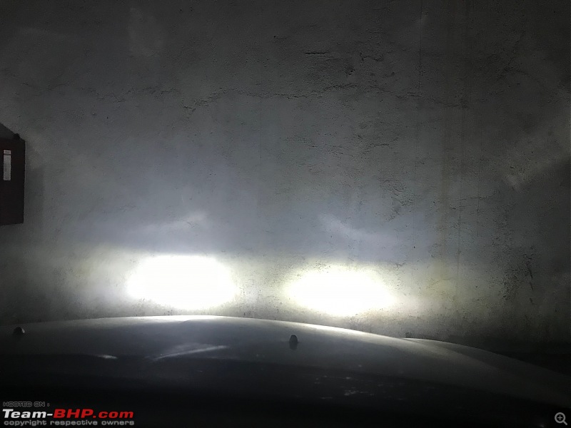

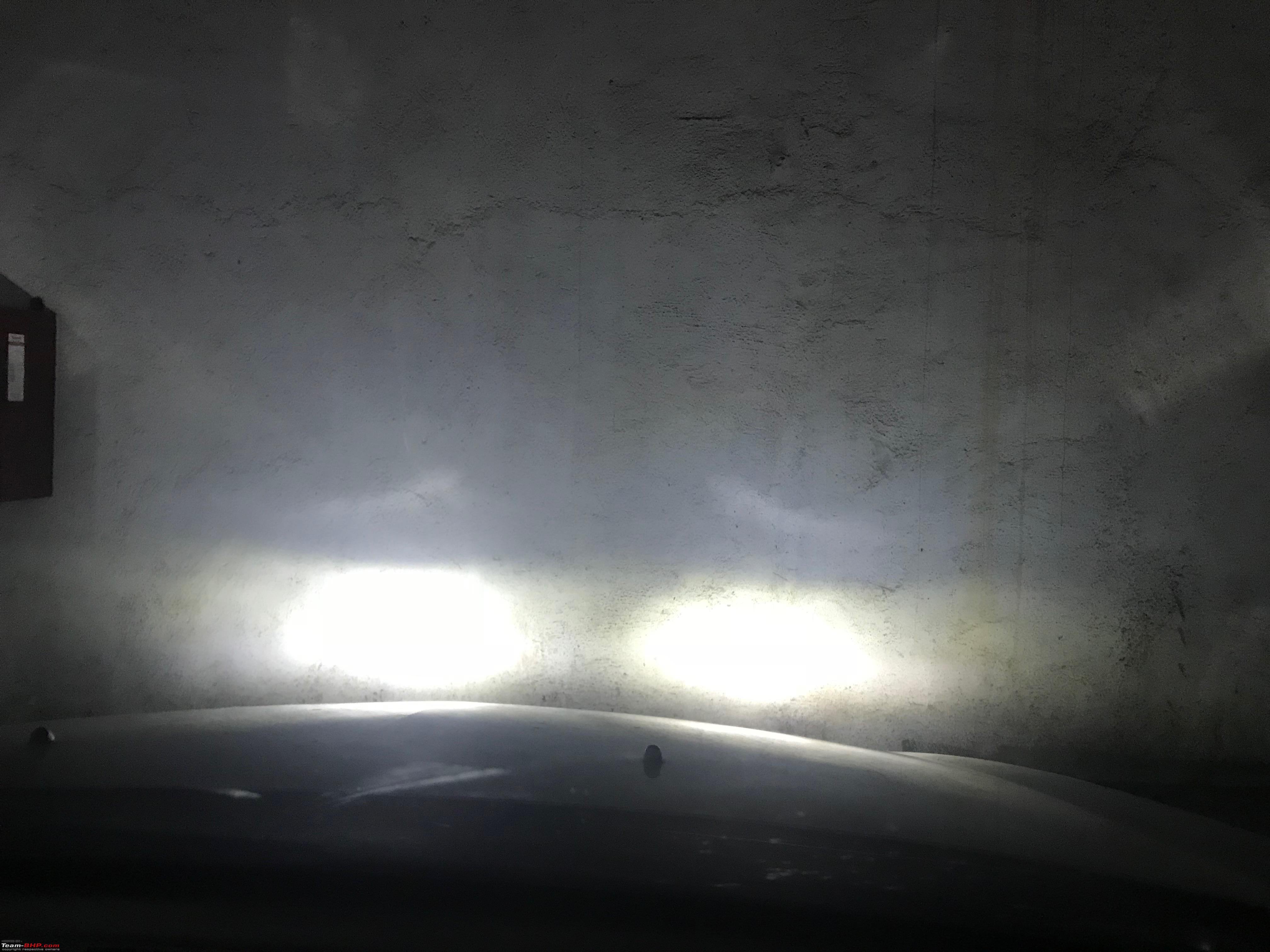

So I took the photos of the beam pattern on my current LED's. Thoughts anyone?
Low Beam
High Beam

Originally Posted by superutp View Post
Thanks will check these out.
As expected the cut off in low beam is not very good and doesnt follow the standard with halogen. It might be impacting on coming traffic. You can try the CSP ones to get better results. Brightness wise CSPs will be similar.

For testing cutoff pattern you need to park your vehicle about 15-20 feet from a wall, on a flat ground. From the the photo it looks like you car is parked too close to the wall.
archat68 is offline
Yes, true, the below image is for around 10-15 feet
Low beam
superutp is offline   (1) Thanks
Low Beam
Attachment 1794577
High Beam
Attachment 1794578
Your low beam is higher than the high beam. Can't make out much difference at all.
Plus as supertinu said, cutoff is pretty bad. The beam isn't wide just narrow and no hot spot clear. This means this will have too much foreground light making it difficult to drive.
Vid6639 is offline   (3) Thanks
Low Beam
Attachment 1794577
High Beam
Attachment 1794578
Your high beam has a cut off line whereas the low beam doesn't have any. That is weird!!
I think the bulbs are not fixed correctly. In a H4 setup the glare shield on the low beam filament should be on the lower side of the reflector. Check or post a close up of your HL setup.
archat68 is offline   (2) Thanks
Low beam
Attachment 1794600
high beamAttachment 1794601
Vid and Archat have already pointed out that at further distance it looks even worse. Hardly any difference between low and high beams. Do you have link of the lights you are using? does the lo beam LEDs have steel cups to block hi side light? That is very important else entire reflector will have a throw. Current setup would mostly be blinding the oncoming traffic even on lo beam.
Yup its pretty clear these bulbs are not a match for the Cruze's reflectors. The link is as follows https://www.aliexpress.com/item/Supe...ceBeautifyAB=0
These bulbs dont have that tiny glare shield and plus they are those Cree with lenses type of bulb. I bought them before any of these LED threads on TeamBHP especially Vid's on experimenting on his ecosport.
I guess I will have to experiment with the CSP in line type with the tiny glare shield ones which mimics the standard halogens. Anybody know a particular model which could suit the Cruze well?
superutp is offline
Just saw the link. Those are terrible!!!!
No shield, uses the dome type array LED and some weird 3 LEd pattern. No wonder you are seeing no difference between low and high beam and no low beam cut off. The light is just everywhere!
