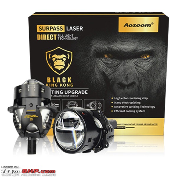

Wait for your fitness to be done with. Then install something like this.

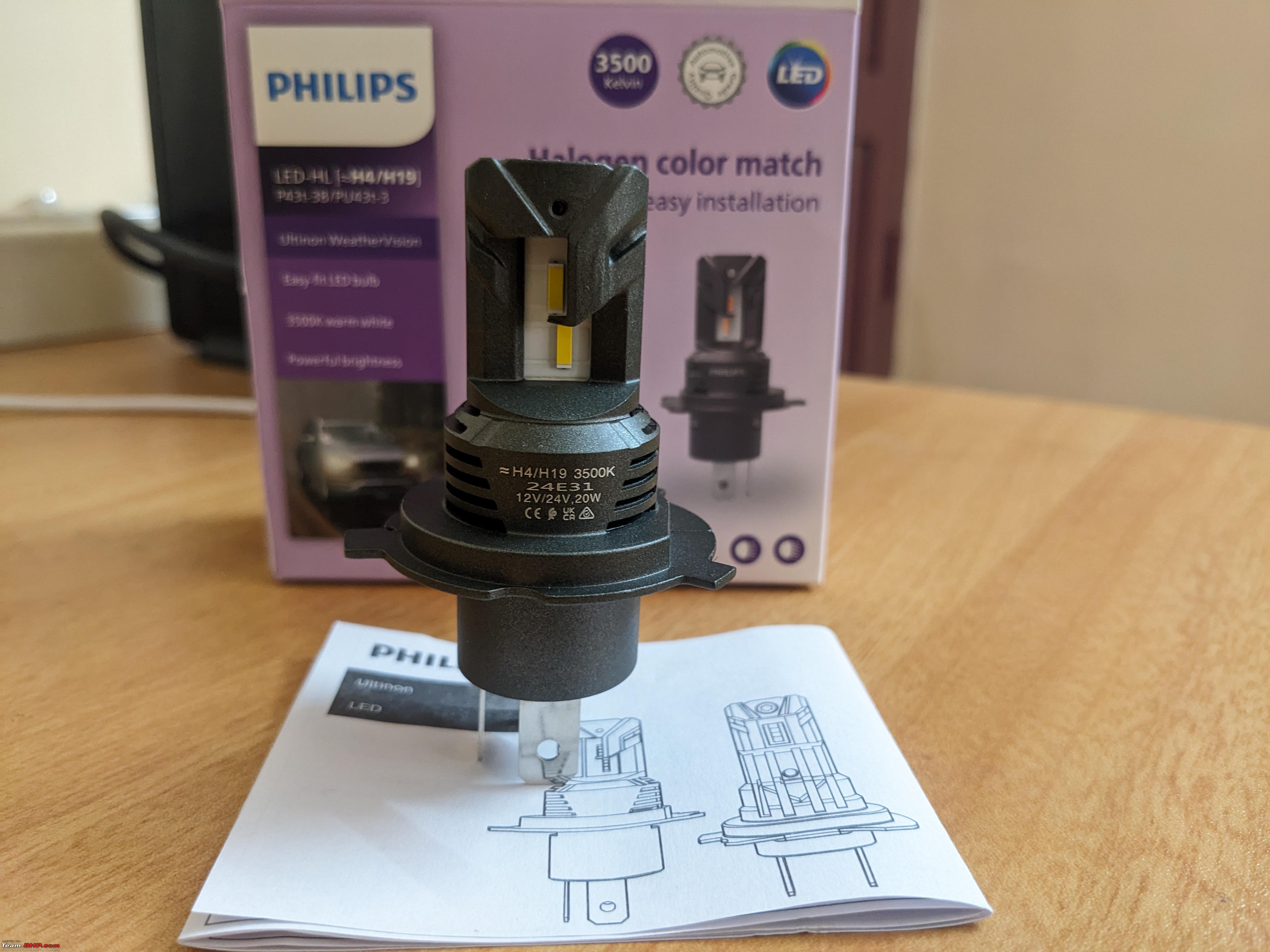

Hi Everyone,
I have upgraded my 2014 Swift's Halogen headlight bulbs to the newly launched Philips Ultinon Weather Vision direct fit LEDs.
The reason why I bought these bulbs is because of their 3500K color temperature (the same as halogens) and direct fitment, which prevents alignment problems.
Pics of Philips Ultinon Weather Vision:
It features a copper cooling tube and active cooling with a built-in fan. Power consumption of 20W per bulb.

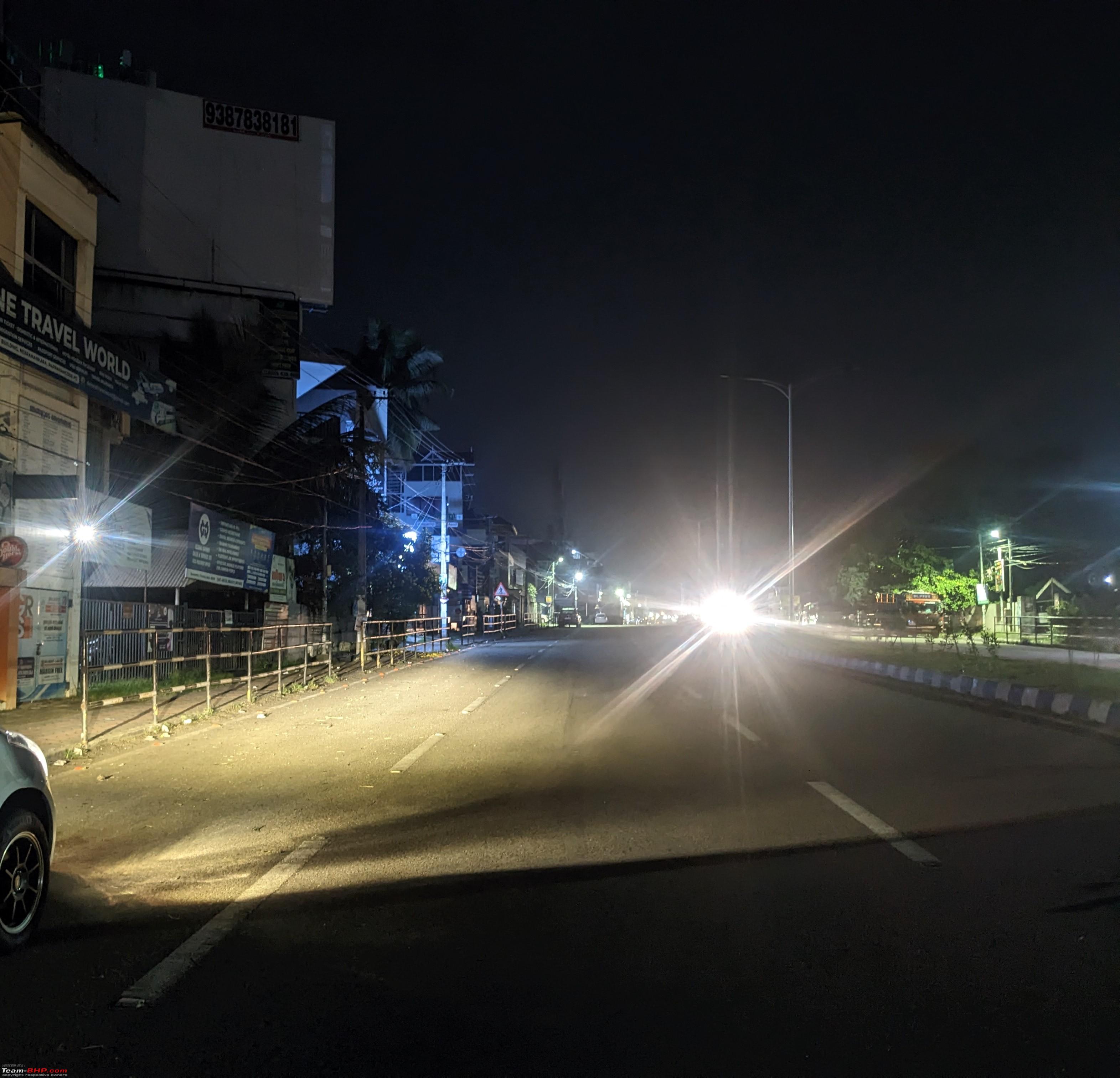

There is an improvement of around 30-35% in the low beam.
The beam pattern is the same as that of stock bulbs, and the light spread is better.
Comprehensive guide to LED Headlight upgrades-pxl_20240822_230906641.night2.jpg
The high beam is significantly brighter than halogen bulbs:
Both LED headlights and stock halogen fog lights are turned on:
Comprehensive guide to LED Headlight upgrades-pxl_20240822_224638442.night.jpg
It's impossible to tell whether it's an LED or a halogen because of the colour temperature.
I am satisfied with these bulbs. I recommend these bulbs to those who are not interested in cool white lights and do not want to alter the dust caps.
