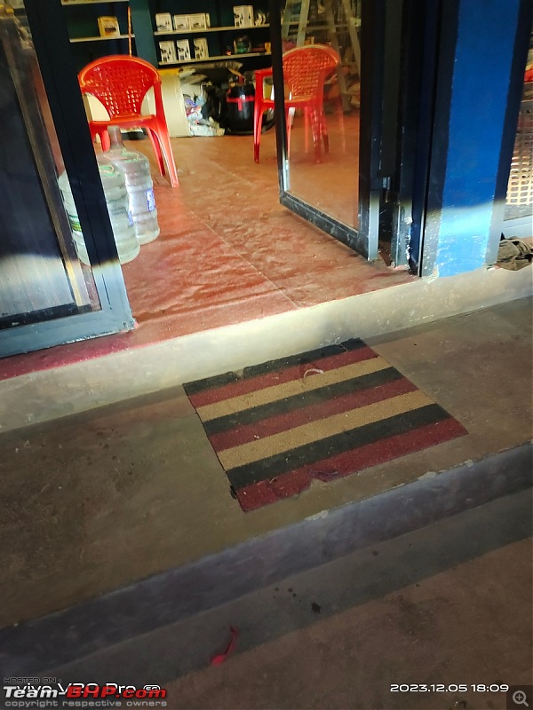

Tata Tigor - Low Beam bulb (Projector) changed from Halogen to LED
Finally, I have changed the low beam bulb (Projector) to LED. The brand name is Drive Maxx, and it comes with 120W Ultra white, 6000K. The company gives 24 month replacement warranty.
I know this is another Chinese make but the shop guy assuring 2 year replacement warranty hence agreed this brand.

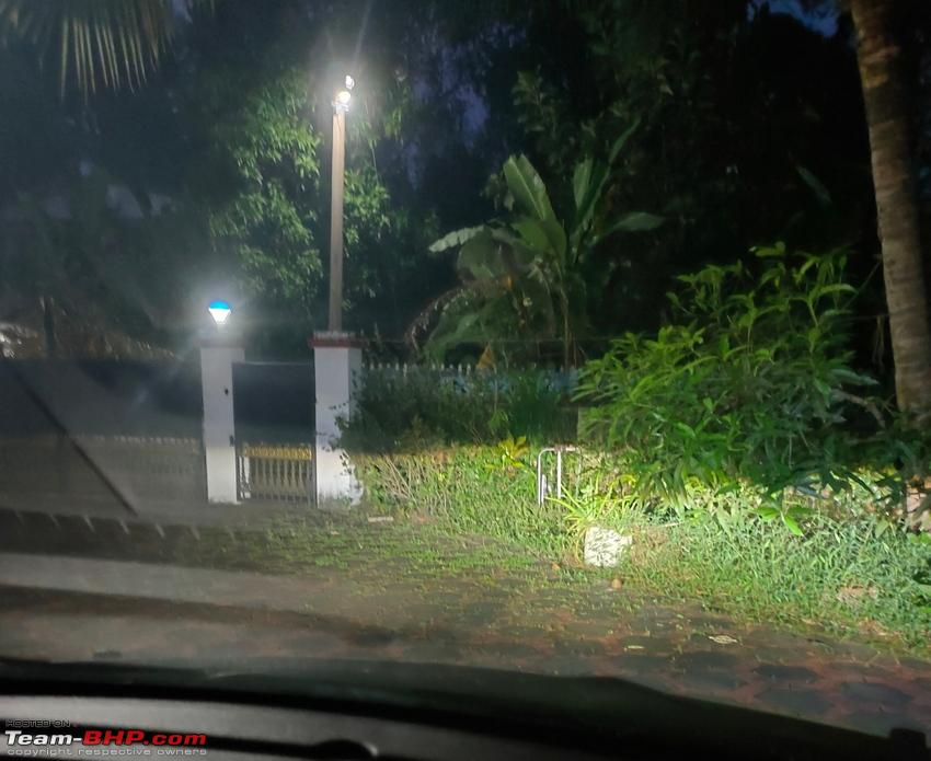

When I drove back from the shop after new bulb installation, the low beam looked very bright and the visibility seemed much much better than the previous one (halogen bulb).
(Low beam - Halogen bulb)
(Low beam - LED)
(Low beam - picture taken at the shop after LED installation)
(Led Low beam)
Will have to check and take some pictures while driving on the road in the night time and see how the difference is.
