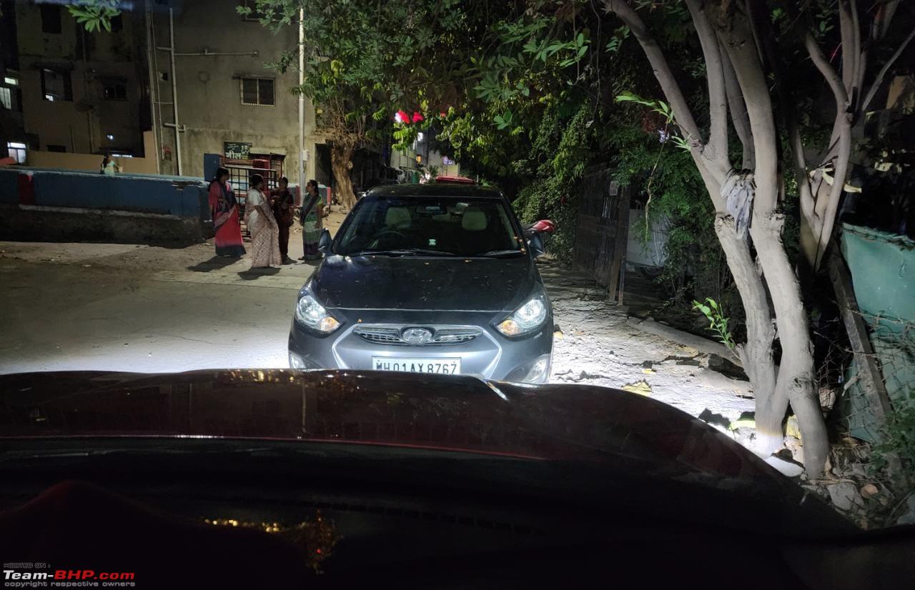

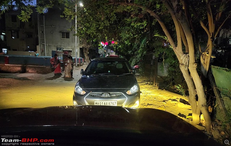

Just sharing the pics with the swapped Fogs for my XUV 300 ..
Had bought 4200K/6000K fogs from the LEDBeam website for about Rs. 3000/-
Got them installed yesterday and the pics are attached for reference pls.

I believe you are talking of these: https://ledbeamtech.com/product/ledb...=h8-h9-h11-h16
But these are 46W whereas XUV300 Foglamps are rated at 19W(H16). Wont it result in heating/excess load on electrical system?
An OEM LED headlamp is ~20W , plenty of heat sinks and even a fan on some , so you think this thing would survive if it draws 46W?
It's all useless , don't fall for it.
Yes, you've got them right!
XUV 300 fogs are 19 watts each. These are 46W, means 23 watts each. I don't think they would cause any overload..
Enlightenment on this is surely welcome!

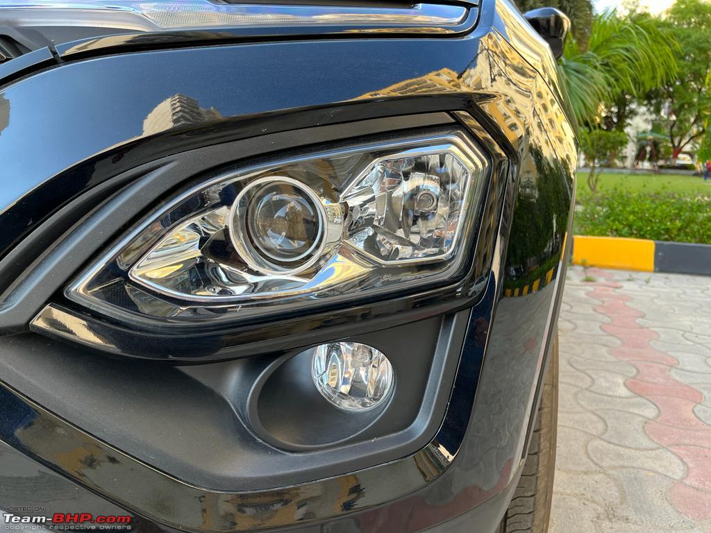

Please share a pic of the your headlight units and also the relevant bulb types (from your user manual). That way the suggestions you receive will be more relevant.
Here You go,
Headlight pic as below,
Comprehensive guide to LED Headlight upgrades-whatsapp-image-20230722-5.19.30-pm.jpeg
Bulb Specification as below (Option 2)
Attachment 2479307
Pls suggest options, my prime requirement is better lighting at night...if Fog lamp upgrade can solve the problem, i am fine with that as well, just that I want minimum possible changes

Re: Comprehensive guide to LED Headlight upgrades
Originally Posted by shantanumishra View Post
Here You go,
Attachment 2479308
Attachment 2479307
Thanks, that helps.
Since you have standard 3 inch fog lights the first upgrade should be to upgrade to 3 inch projector fog lights. You can go for either GTR 4300K projector fog lights or IPH M617 tri color 3000k/4300k/6000k projector fog lights. Both are typically available between 8-10k for a set.
This video shows what the GTR fog lights look like.
GTR also have launched an improved version too callled GTR pro. You can also check that out too.
https://carconceptsshop.com/products...s-with-bracket
These upgraded fog lights should solve your low beam problem to a large extent. However if you want to upgrade your High beam halogen bulbs too, you can go for Osram LED 50w 6000k bulbs.
These ones in H7 should be the correct one for you (as per your manual, but please reconfirm before buying)
https://www.planetcarcare.com/produc...00k-6000k-pair
Both these options are generally available in good accessory stores, but if you are unable to find them you can order them from the links.
