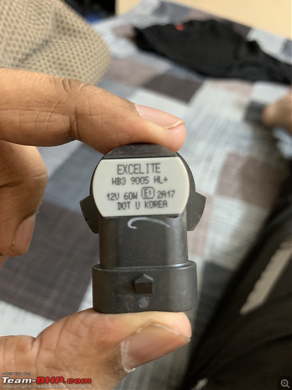

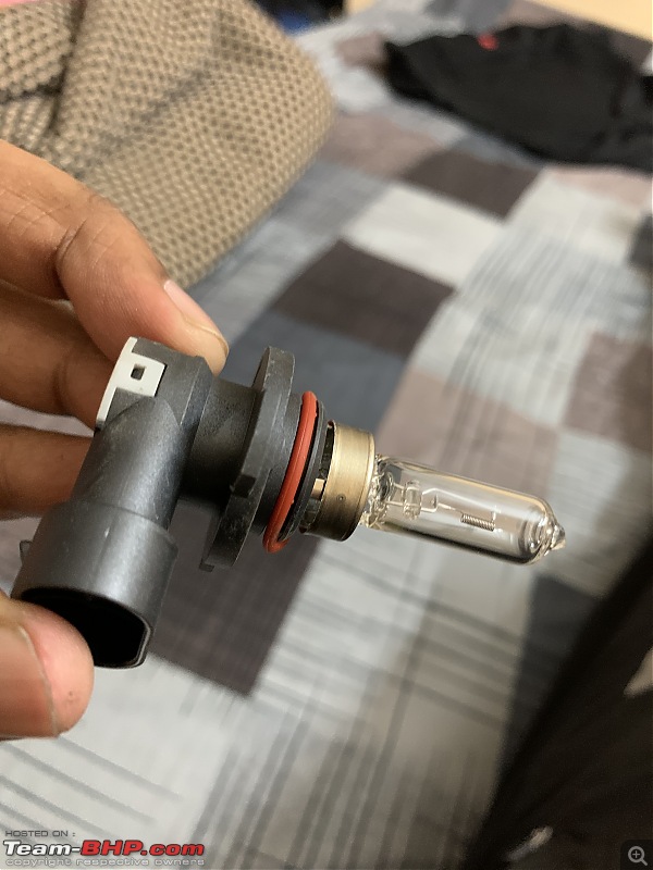

Upgraded stock halogen bulb of my Hyundai Venue SX Plus’s projector setup to these-
Comprehensive guide to LED Headlight upgrades-d183b700703f433f81c0cc076b7a6c0d.jpeg
Stock bulbs -
