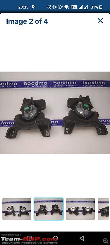

Originally Posted by JKBKS View Post
I zeroed in on Behemoth's solution of going in for M617 tri-colour projectors in place fog lights and let the halogen headlamps be. M617s are 3 inch. But my 2009 Scorpio has a 5 inch housing that's too big for these 3 inch projectors. I am told M617s wont work in Fog lights housing of Scorpio so I have to now look at upgrading the headlamps that have a reflector housing. Since projectors don't seem to work will in reflectors I am thinking of getting 55W HIDs now.
Yes with 5 inch the 3 inch IPH M617 will not fit. However I was searching for some solution for you and I came across this on Boodmo (just search Scorpio fog lights). It seems the 3rd gen Scorpio comes with smaller 3 inch fog lights which have a large plastic bracket which fit in the 5 inch holes. Please see pic below
https://boodmo.com/catalog/part-fog_lamp-55970398/
Comprehensive guide to LED Headlight upgrades-screenshot_2022081920351267_21d7ae11b56d281f3d1eaf85000220e7.jpg
Maybe you can try ordering these (they are not too expensive) and then decide what to do next. Even if you go the hid route, do take projector based HID housings. Putting HIDs in reflector housings just scatters light everywhere and blinds others and will do very little to improve your own visibility.
Attachment 2348321
Thanks again Behemoth for taking time to search!!
Didn't know the HID and reflector housing correlation. I seem to learn something new every time I post here
Will buy these and try getting 3 inch projector fog amps installed.
Another quick question: If M617s are not available locally, are there any comparable 3 inch tri-colour projectors from AES and Aozoom that could be selected instead?
JKBKS is offline   (1) Thanks
Attachment 2348321
I just saw a Youtube video (link:) of old Scorpio conversion. The foglamp housing video starts at 4.06. There they used original Mahindra housing which fits 3 inchers perfectly. Below are the screenshots. If I could get these then the problem will be solved.
But on Mahindra Automall they are selling this as a complete fog light unit. So would need to find if the housing cover could be bought standalone.

This might work for you.
https://boodmo.com/catalog/part-beze...plus-39777780/
Order one first to check the fitting though and then only order the second one and the Lights.

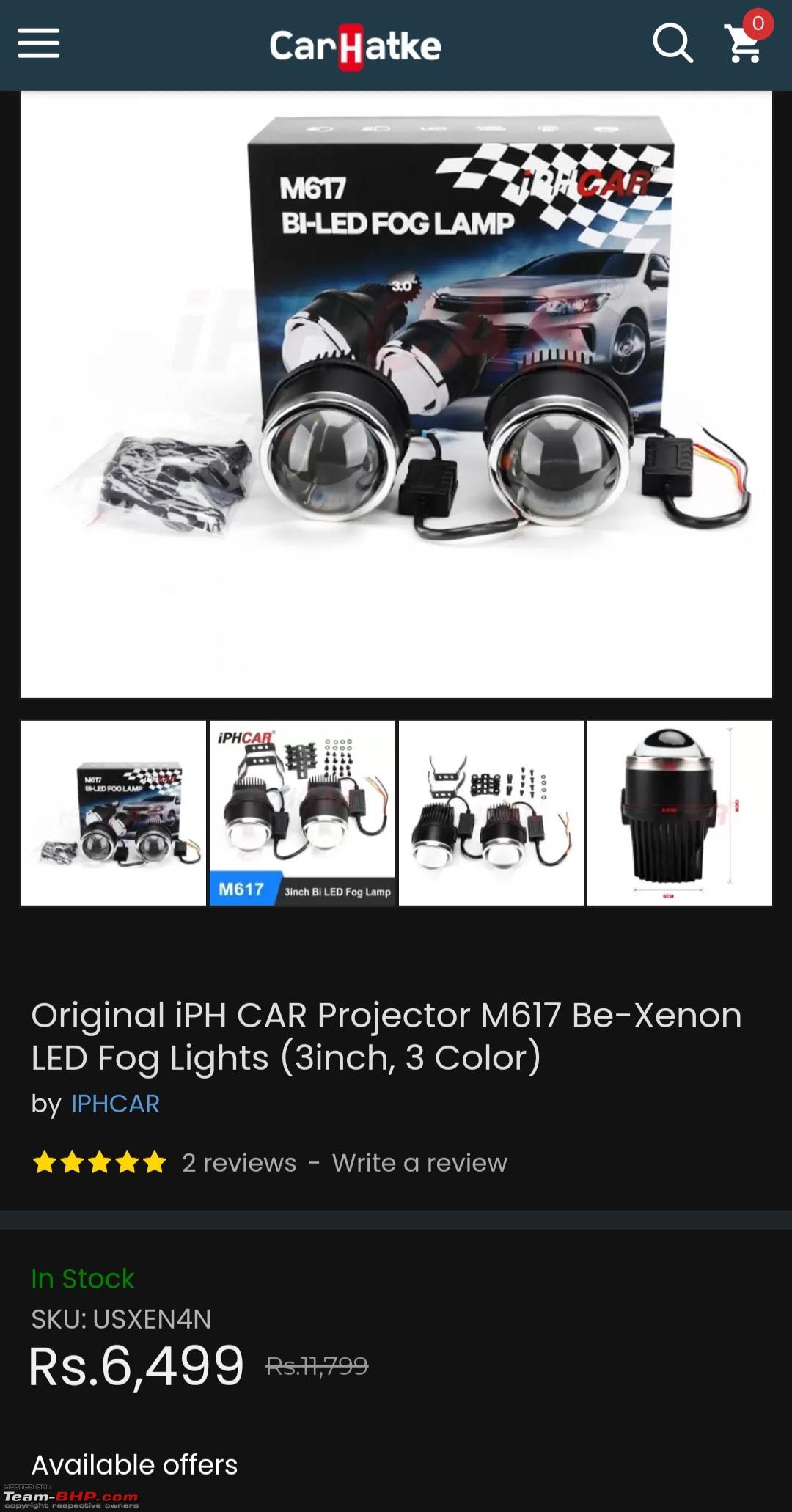

Hello Behemoth.
I am planning to upgrade the fog light assembly on my 2020 Ford Aspire TDCi. Found the IPH M617s on carhatke. Could you kindly share some long term feedback of its usage (especially in rain, the variable color must be a boon!).
https://carhatke.com/iphcar-m617-be-xenon-led-fog-lamp

Originally Posted by TDCi4Life View Post
Hello Behemoth.
I am quite happy with them and find the beam focus and reach perfect. Though I am using only in low beam mode as I did not want to tap my high beam wire as that would void warranty.
In rains, I was using in 4K mode and it works well. In fog (in winter) I will use in Golden mode, but last season there was no fog at all so did not get to use
Rest of the time I use in 6k mode as that is the brightest and gives good visibility on black topped roads.
At this price quoted, you are getting a pretty good deal. I had got mine for around 8.3 k as that time supplies were ready short due to Covid impact on imports. I would recommend them fully to you. However please check that the fitment (size and mounting) will work in your car.
Behemoth is online now   (1) Thanks
