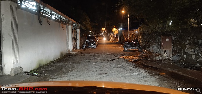

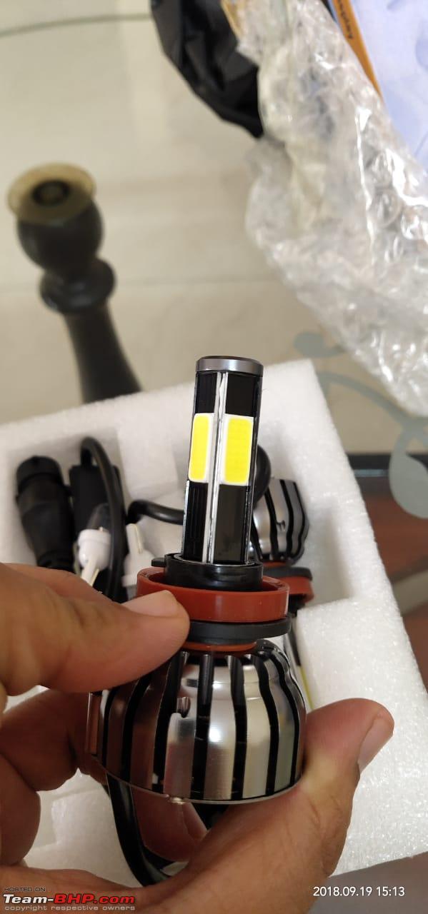

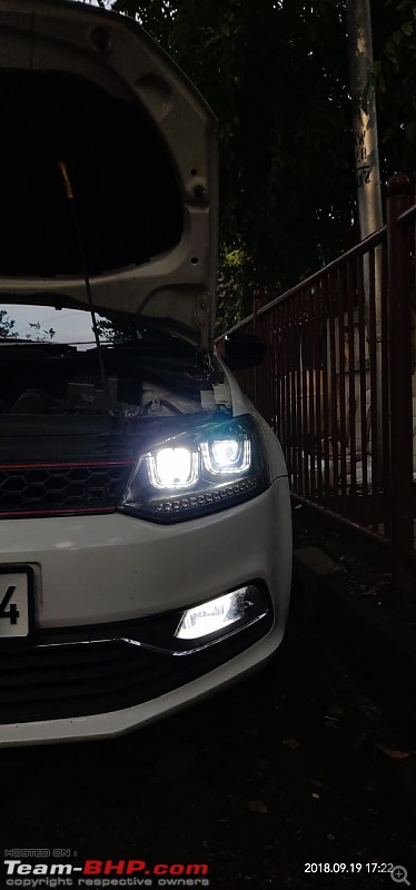

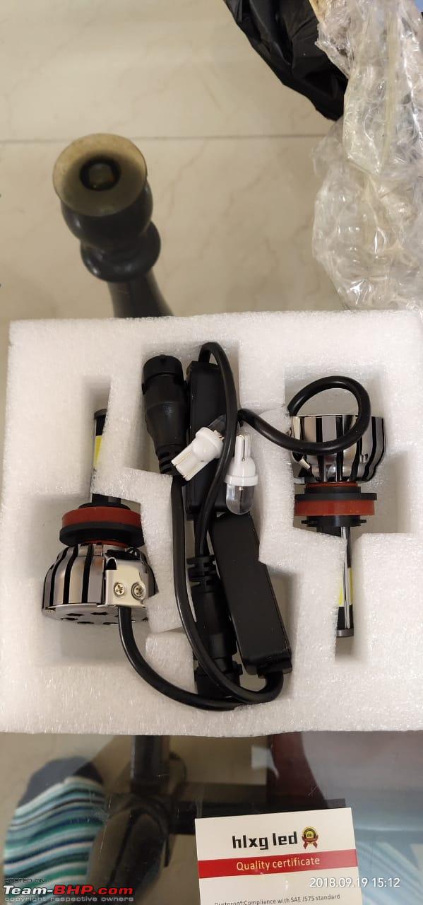

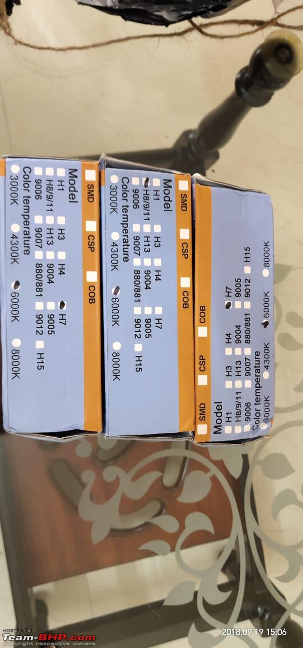

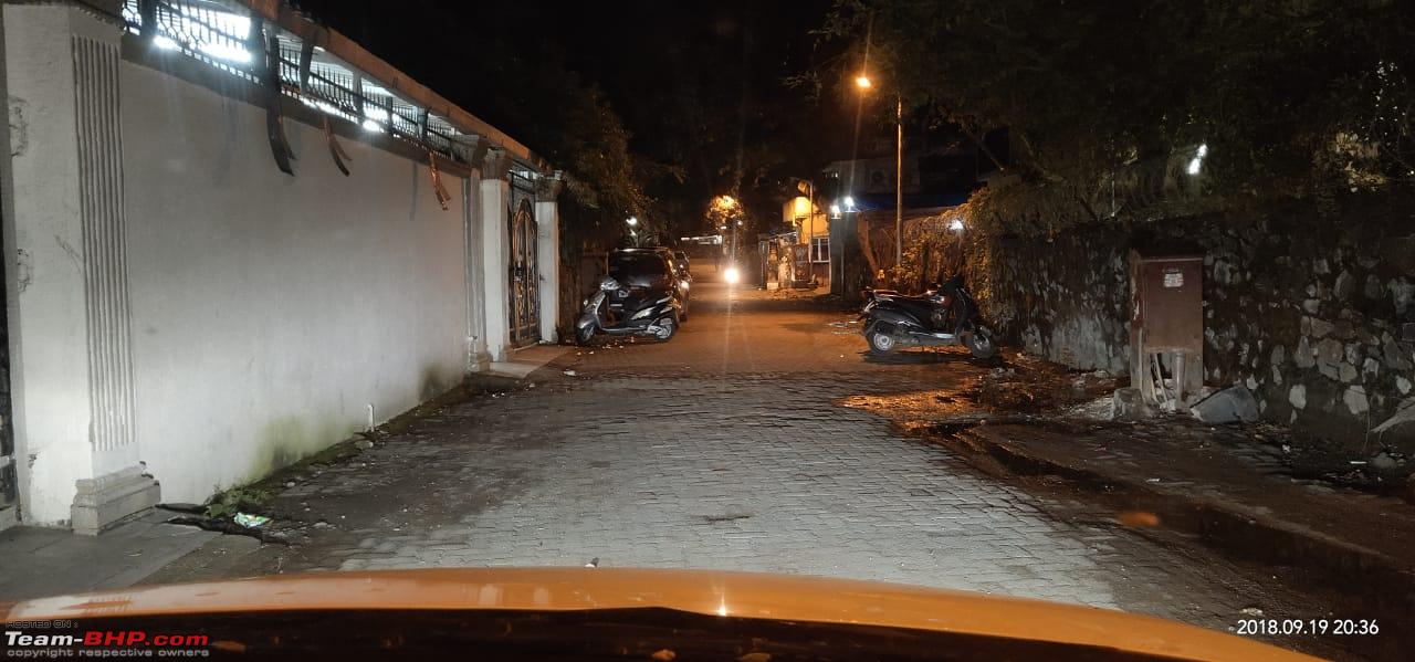

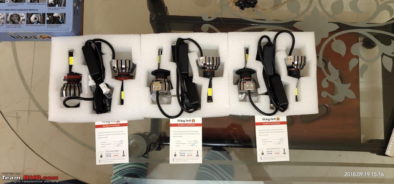

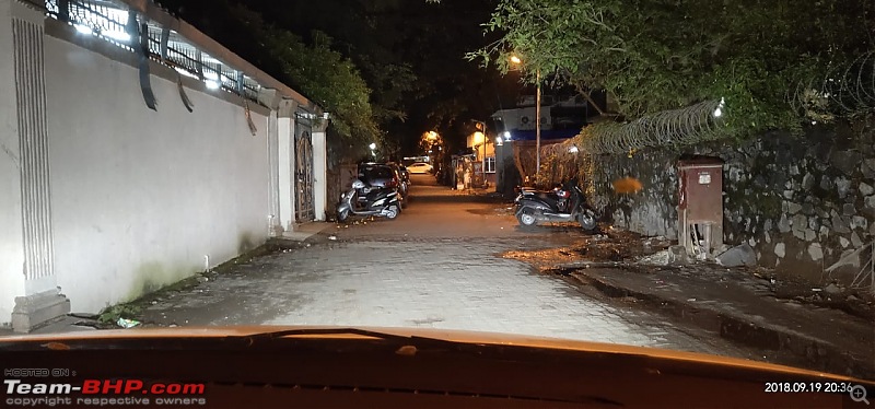

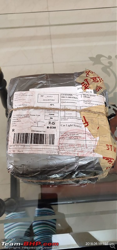

Look at what the Post-man just dropped!
Positives
+ great visibility at night
+ insane spread and uniformity
+super fast on and off.
+insanely good for high beam
+fog lights do most of the heavy lifting. Low beam is just a formality.
Negatives
+cutoff line more visible in xenon
+special alignment needed. I need to align my low beam to use it better. The high beam lights up the road like day and so do the fogs. I must align the low beam for the area in the middle.
+visibility poor to abysmal in street lights due to the temperature
