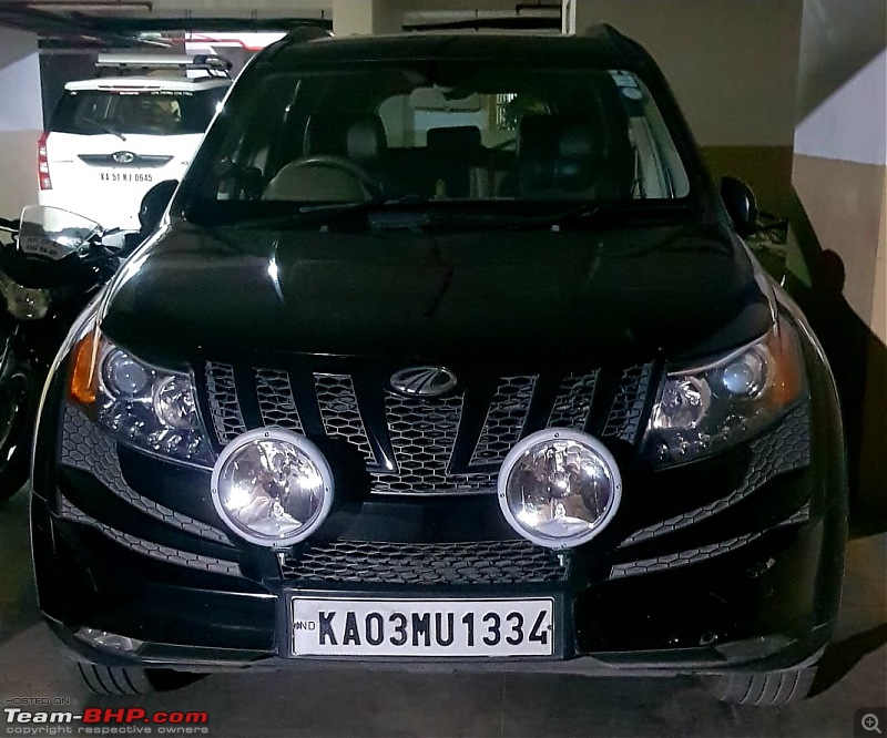

Made below modifications to my Beast
- P8 HID for Projector
- Osram Night breaker for high beam
- Hella Rallye 3003
- White LED for Fog lamps
Comprehensive guide to LED Headlight upgrades-whatsapp-image-20190926-21.18.09.jpeg

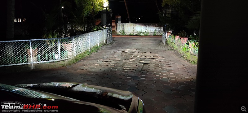

I’d recently upgrade my Rapid’s low beam projector and high beam to p6 LED H7 6000K. After the swap, in the bright mode the centre portion of the road is not lightened up. What might be the cause? Is it normal with LED?
Comprehensive guide to LED Headlight upgrades-3bec3c5144284edeaefba01820860a37.jpeg

Did you pick up the Osram Nightbreaker H4 which costs 1.9k a piece? How has it been so far? What about the fog lamps? Which brand are you using?
I am planning to upgrade the high beam and the fog lamps in my 2011 XUV. I would really appreciate some inputs.

Osram Nightbreakers are great. They provide good visibility. Most of the times this is sufficient.
Fog lamps, I don't remember the brand right now.

The lights are not aligned properly. I'm not sure if in the above photo you have switched on both the high beam and the low beam , but irrespective of that we can see a lot of shadows. One of the reasons would be that the bulbs are not aligned. The LED's should be in positioned to the 3'o Clock. The manual should throw more light on it.
The circled area should have the hot spot of your low beam.

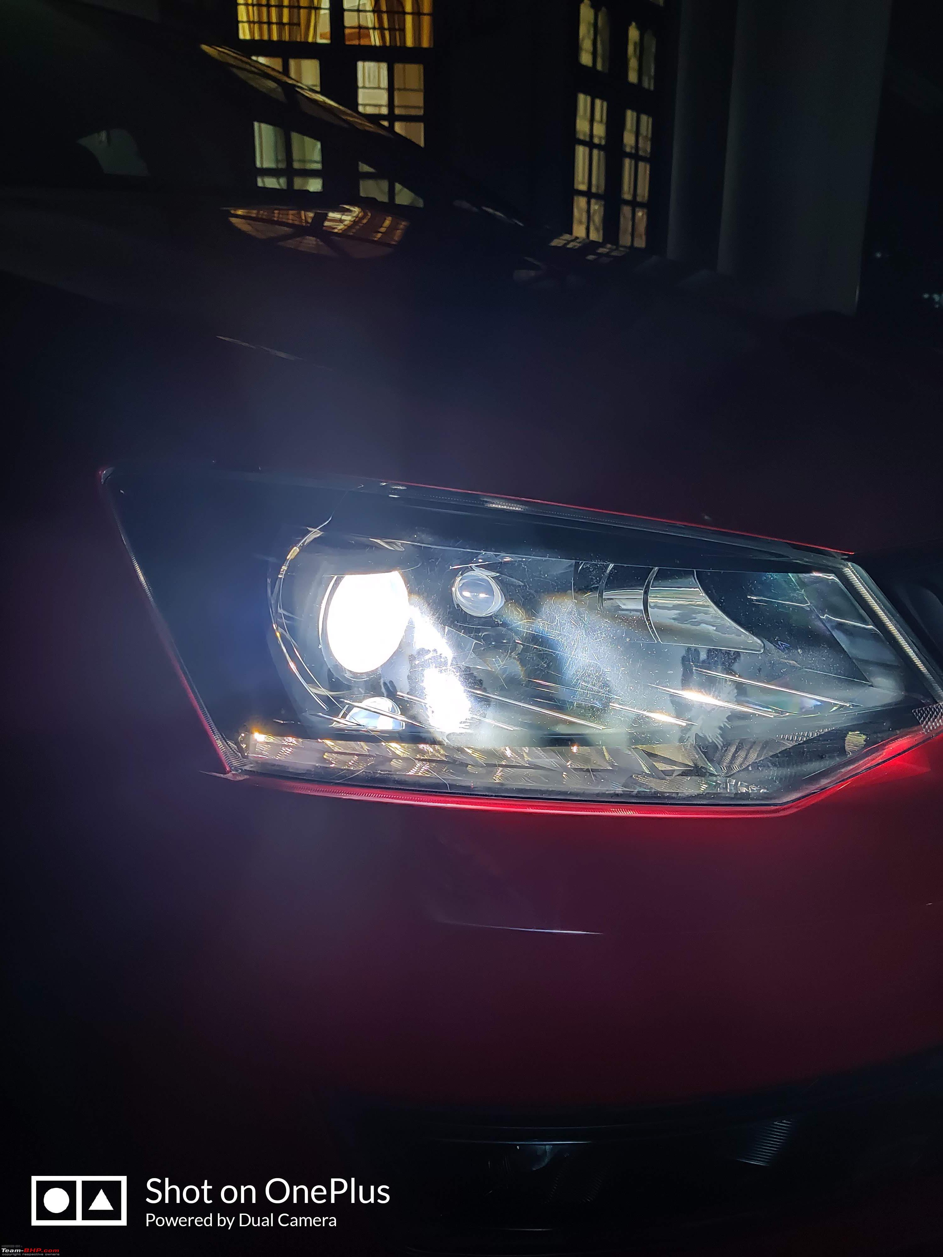

The pic is with both the high and low beam in on position. But my low is projector whereas high is normal halogen but both led bulbs are same. The guys checked once gain but couldn’t correct the right alignment.
Projector- low beam
Comprehensive guide to LED Headlight upgrades-8ed91a905be649668d1720e867f09a71.jpeg
Projector with high
Comprehensive guide to LED Headlight upgrades-14e267aa6a6047a69acf716f249df27d.jpeg
Light throw with only projector
Comprehensive guide to LED Headlight upgrades-dda76015fd3c4991972b64b5fe9a55d6.jpeg
