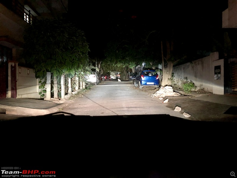

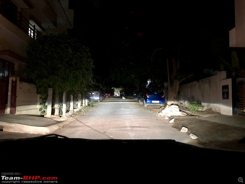

Yup this is the one. It’s called “iLens”. It produces a perfect 5000K light. Instant on and the flash is very prominent. People give way instantly.
P.S: ignore that line at the bottom, that’s a huge crack on my windshield
Here are some output shots
Comprehensive guide to LED Headlight upgrades-480b3c60e7a04fc3974fbaa1e796387a.jpeg
Low beam
Comprehensive guide to LED Headlight upgrades-a1df4d2784884a488236cd96b38b3688.jpeg
High beam
Does it have any bulbs in there? What do we do if the LED conks off?

They have LED chips inside that emit the light that is reflected onto the road by a reflector bowl. No bulbs of any sort. If and when the LED conks off, the projector will need to be replaced but I don’t see that happening. The newer cars all use LED projectors.

From the pictures the spread looks outstanding. Hows the reach with high beam on the highway?

My experience tells that LEDs on high beam dont work well unless very focused since they tend to disperse more. I have reverted from LEDs in my car's high beam to Osram night breakers. One short drive in the night on a dark highway was enough to help make that decision.
