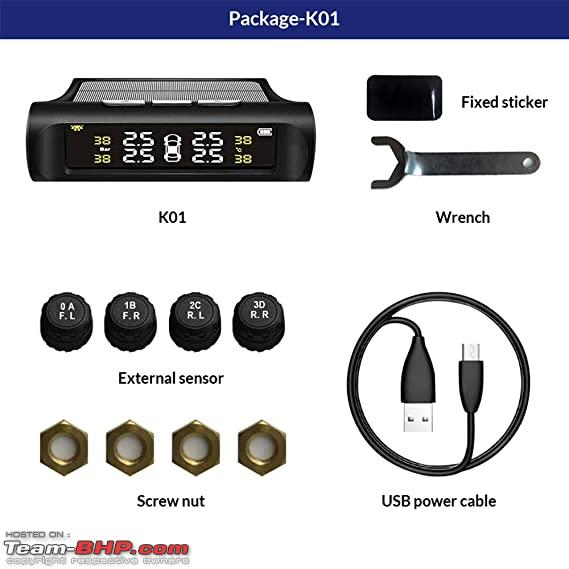

Originally Posted by ghodlur View Post
Aren't the external sensors prone to theft or physical damage? Plus every time the tyre has to be filled, the sensors have to be removed, wouldn't this affect the accuracy?
They are to installed using a special mechanism (nuts and wrench) and the wrench is to be kept in the car at all times else they wont open.
The nuts and wrench is to keep the neighbourhood kids away though and any professional thief should be able to steal them.

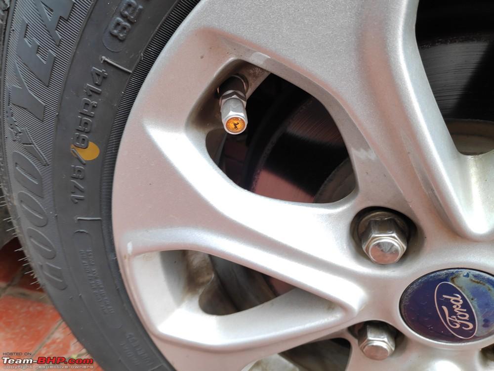

I recently changed the tyres of my Ford Aspire. Along with the new tyres, I also installed an internal TPMS. Generic Chinese import from Amazon.
Within next 3-4 days, the front left tyre showed PSI of 17. I went back to the tyre shop and a minor leak was detected between the rim and the tyre due to rust/dirt. It was cleaned up and tyre fitted again. No leaks since then. The TPMS came in handy immediately for me.
The display unit came with useless double sided tape which barely stuck. I had a 3M tape lying so used that and the display is firmly in place. The display turns off automatically and turns on, upon slightest of movement. Opening the door turns it on. Initially I thought the display was faulty and was not turning off. I called the support number which was printed on a page that came with the TPMS. He asked me to observe the display before opening the door. I did that and realised it is sensitive to movement.
