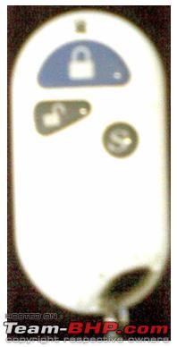

Originally Posted by Epic View Post
Doc, do you mean to say that one cannot have them intigrated to an aftermarket remote and can only be intigrated to remotes provided as OE?
Well if your original key is just a key, and you have an aftermarket or even OE remote like below
If this is the case then all that matters is if your key has a transponder.
The flip keys will accommodate your alarm system's fob guts, but if your key has a transponder then it requires some soldering onto the alarm system's board.
This is something I do not recommend, simply because I have my reservations on the same. But I'm sure it's possible and will work reliably.
What I had mentioned earlier referred to cars with transponder keys and integrated remotes. There are flip key cases out there which are made to perfectly accommodate your original key.
