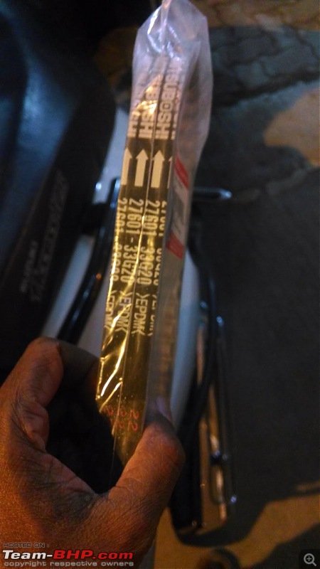

Got the V-ribbed belt changed on Saturday.
This took care of the 'klich' sound that came while accelerating from slow speeds.
The belt cost Rs. 430 and the labour was Rs. 150.
Now, it is time to fix the low light from the headlamp.
Some pictures of the belt and the installation.
I compared with the belt that came out and the quality was the same - so this is original.
The older one was a little lose.
