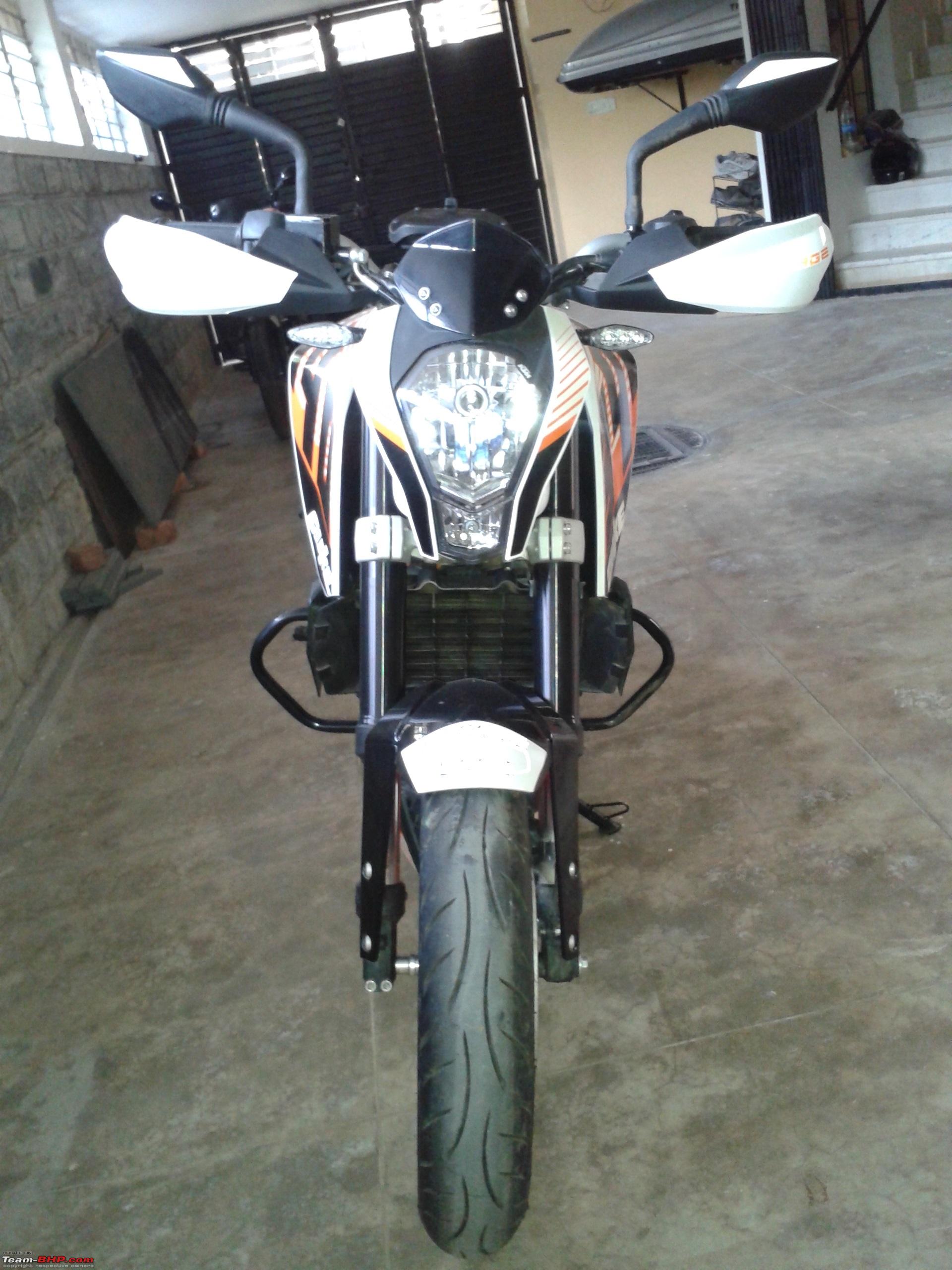

I did a couple mods to the Flamberge - thought I will share with the group.
- Did a little bit of stickering to improve visibility mainly & also to personalize the bike.
The wheels
My Flamberge (KTM Duke 390) Ownership report - A middle aged man's perspective-stickering-20131114_084128.jpg
The hand guard
My Flamberge (KTM Duke 390) Ownership report - A middle aged man's perspective-flamberge-logo-20131114_084032.jpg

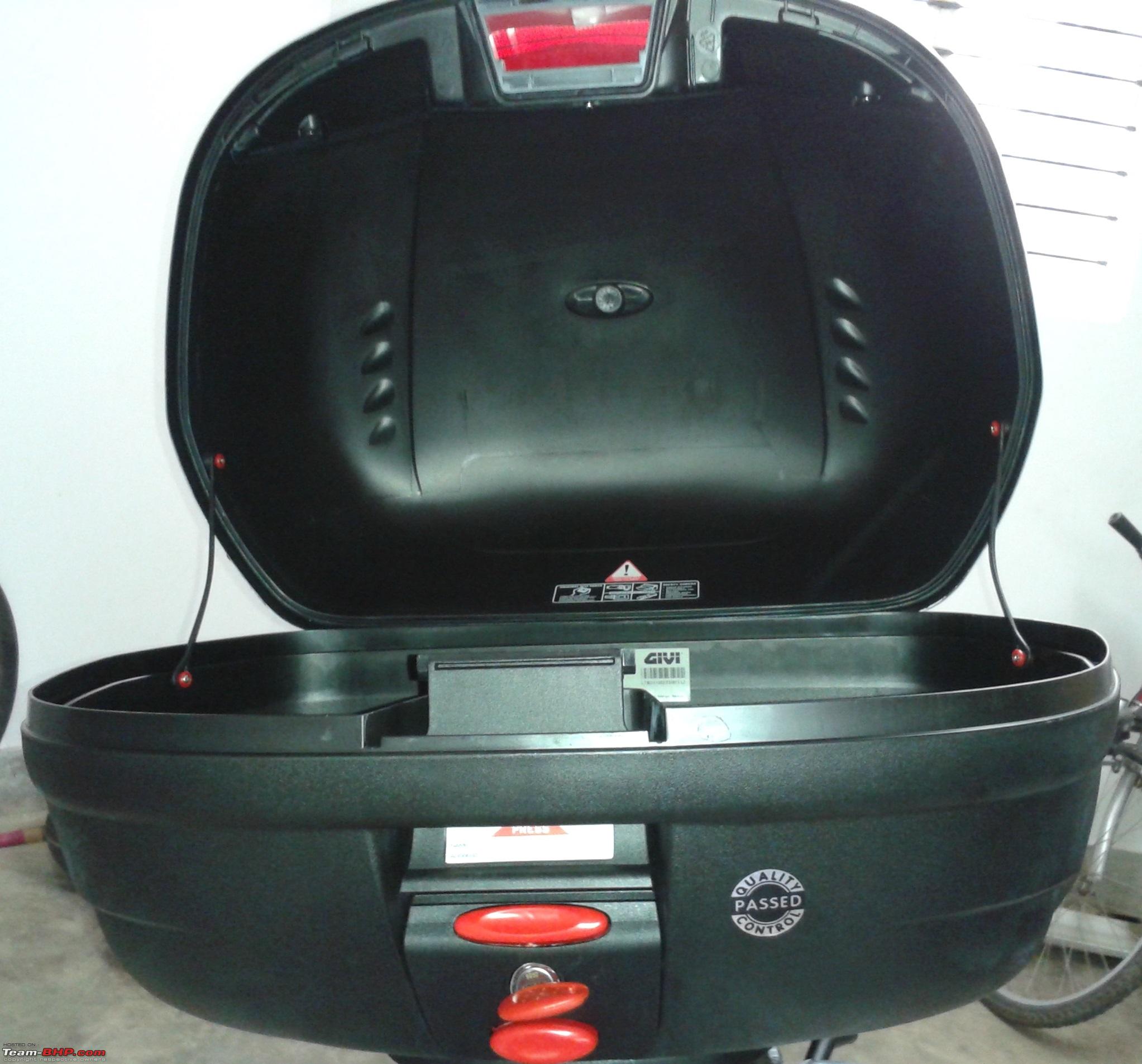

While I am doing this, I thought I will post a few more images:
The rear view of Flamberge with the Givi
My Flamberge (KTM Duke 390) Ownership report - A middle aged man's perspective-flamberge-rear-view-box-20131114_084539.jpg
The attachment detail of the frame. (Tried reusing the original bolts. Dont - the spacer is essential. Otherwise the gap is too much. The OE grab handle has a welded on spacer underneath)
My Flamberge (KTM Duke 390) Ownership report - A middle aged man's perspective-frame-20131114_064500.jpg
The Givi - open
My Flamberge (KTM Duke 390) Ownership report - A middle aged man's perspective-box-open-20131114_084510.jpg
