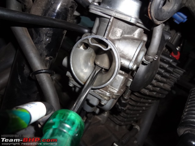

You could push the manifold over to one side and have a look at the slide now. Lift and drop the slide a couple of times with your finger to see if all is well.
Don't use a screwdriver as I'd used back then, I was young and still had a bit of the stupid streak left in me.

Sound like you have an issue with the vacuum piston.
In CV Carburetors the slide is operated by pressure differences, if the slide is stuck or not moving freely what happens is you get a lean state when the throttle is opened.
This explanation makes sense since after starting when you open throttle your AFR becomes lean and the motor dies, also makes sense that while riding you loose power to only regain it when you close and open throttle.
Remove the insulator on the Air Box side and lift the slide using a finger and then let it drop, it should be coming down with resistance, also blow compressed air into the top ports, this should cause the slide to lift, if not then you'd need to change the vacuum piston, at times the carburetors body would've gone through enough wear and tear that even with a new vacuum piston it'd not maintain a seal, in which case you'd need to change the carburetor.
If at all changing carburetors do compare prices with the BS29 available for the P180 as RE tends to charge a premium for its spares. I'd recently bought a BS29 for a friend and it cost about 2.5k. You can swap jets if required.
Now all this is provided that you've already inspected for an air leak, you do it using WD40 on a hot motor or when the motor is hot you could try pulling the Choke to get an idea of state of tune.
ashwinprakas is offline   (1) Thanks
