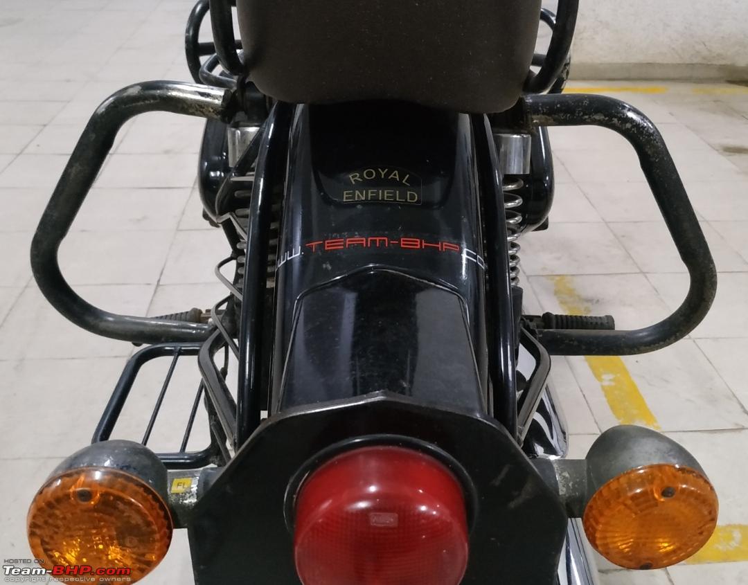

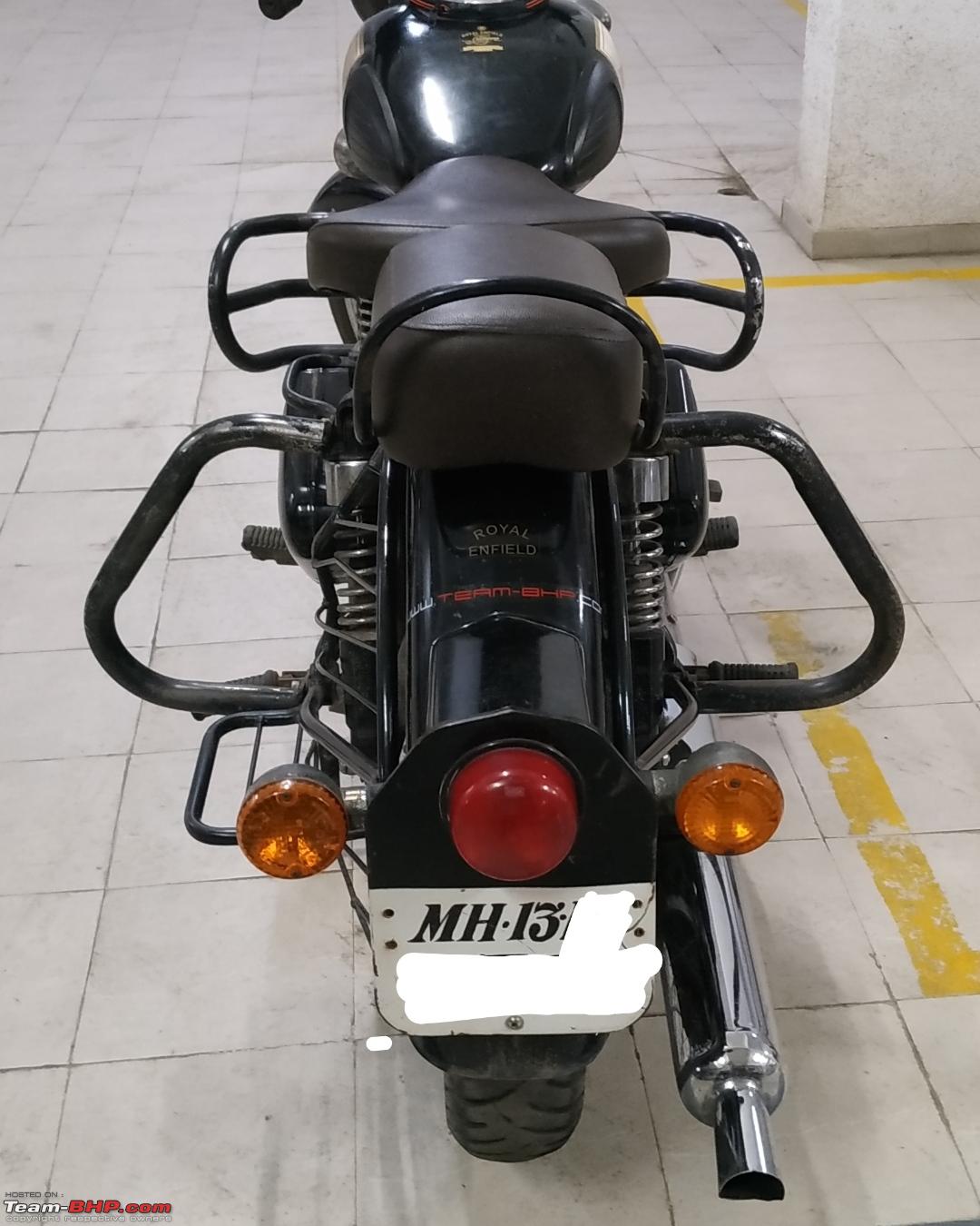

Originally Posted by TM_Turbo View Post
Will update once I check the top speed.
Below is the pic of my bird
Royal Enfield - Troubleshooting and technical support thread-63fd9d6dd17745d6acc18f4805a8b9fe.jpeg
Royal Enfield - Troubleshooting and technical support thread-ddc82e69b0864a508abb2e30f56c2a80.jpeg
