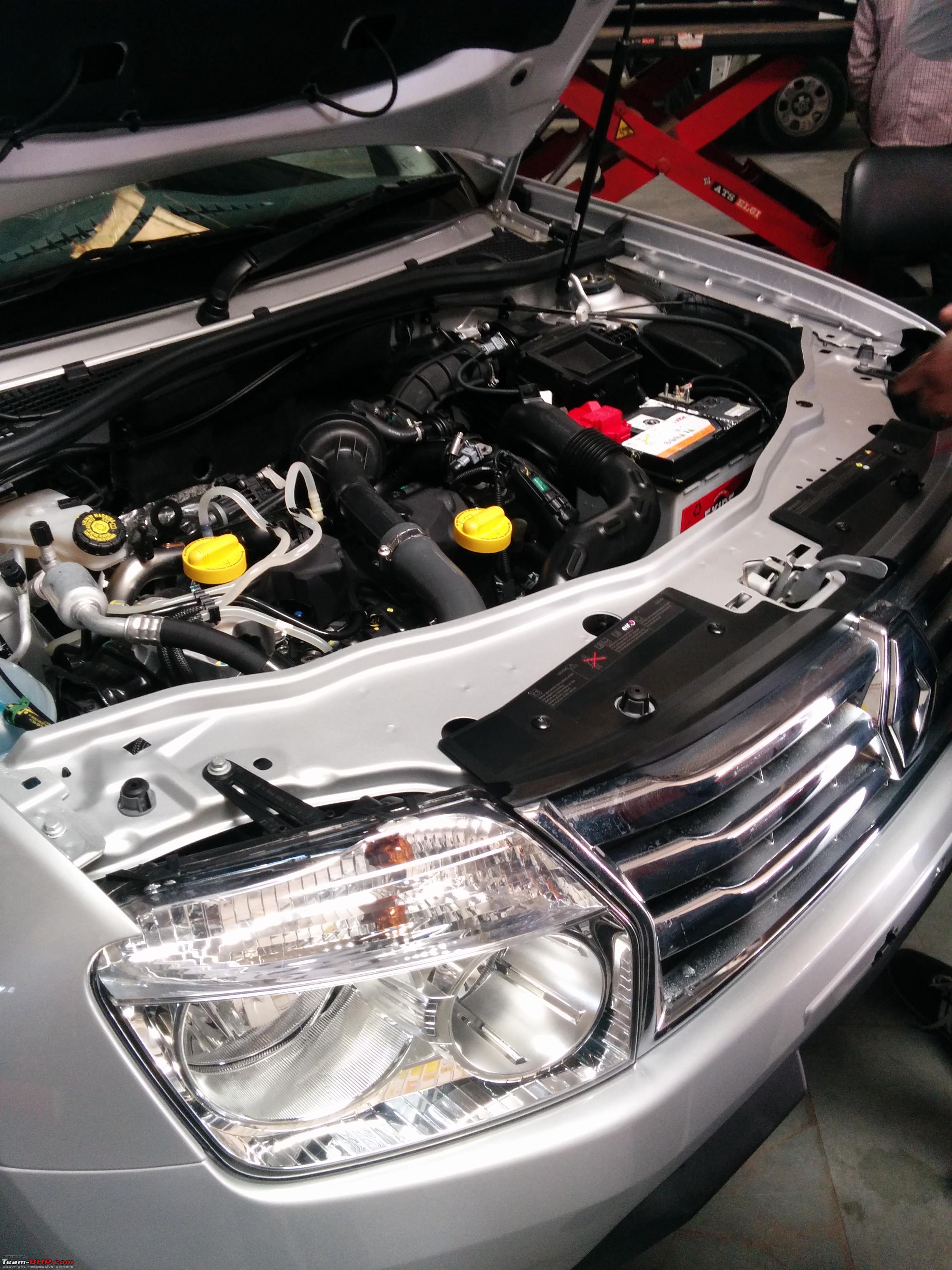

I had my first service today and it was free although the advisor tried to play a sales guy and sell me a few things but that is kind of becoming a trend with all the companies these days. I did see a couple of guys pay Rs 800+ for the first service.
I got a chance to click a few pictures of the changes in RXL(o). Most of the changes have been shared in earlier posts. Engine bay looked a bit different to me:-
Renault Duster : Official Review-img_20141223_142415.jpg
Renault Duster : Official Review-img_20141223_142411.jpg
Renault Duster : Official Review-img_20141223_142433.jpg
Renault Duster : Official Review-img_20141223_142427.jpg
