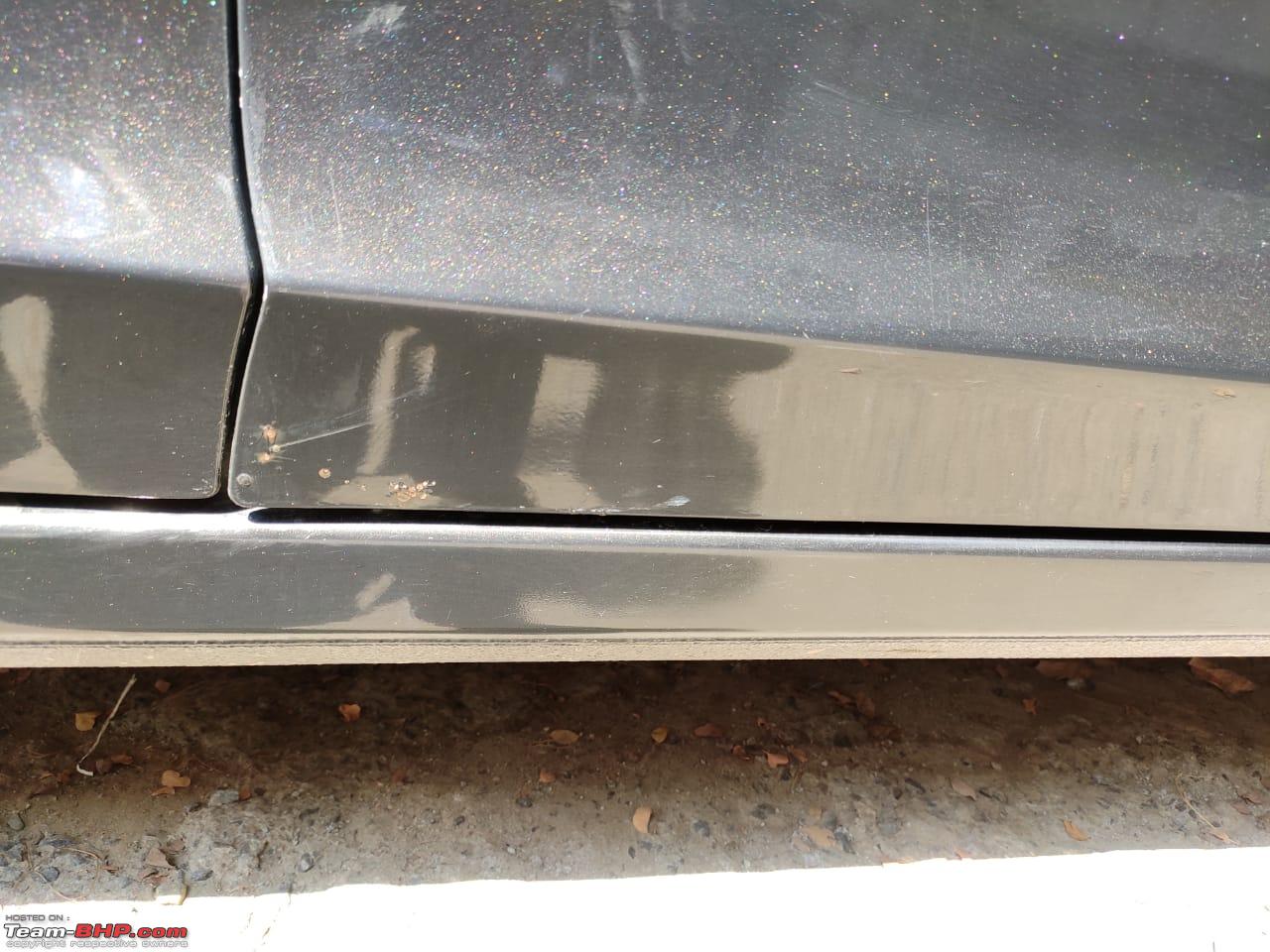

Dot rust on my City door
Why is this happening and what can be solution for this?

Re: Dot rust on my City door
Can you explain what this is? Are you referring to any door alignment issue or is it the scratch markings?
Oh, I am sorry, the brown dots that you see in the pic are rust. That is the issue. There are 3 to 4 dots. The door was never repainted so I don't think there was any exposed metal. Still, this rust, that too in the middle of door surface (unlike usual rusting that starts at edges).
As the affected area is very close to the floor, I suspect the paint must have been chipped by some small stones/pebbles that keep 'flying' around on our streets. They can very easily expose the metal and the rainy season must have helped speed-up the rusting.
Any suggestions on how should I stop its propagation?
Any suggestions on how should I stop its propagation ?
If these rust spots were not there since a long time, it is most probably surface rust which should go away after a good polishing/detailing session. After that you will be able to see the bare metal and that will need a touch-up using a fine brush to prevent your problem from happening again.
Just remember that everytime your car goes for polishing/detailing, that touch-up paint will mostly get removed and you will have to redo the same to prevent rust formation.
If it is not surface rust; the paint will have to be stripped around that area, the rust treated and then painted. There is no short cut if the rust has started to actually eat the metal as it will spread like cancer.
Also, if the paint has started to bubble in some other place, it means that rust has hit that part too. It is just a matter of time that the paint will fall off and expose that rust.
If your car is still under warranty / extended warranty and the rust affected part has never been repaired / repainted, then write to Honda for an FOC repair / replacement.
My 2016 City was fixed by the dealer after I complained to them about the issue. They took up the issue with Honda and someone from the company came down to inspect my car before approving the repair. It is a time taking process but you have to be patient. My dealer was supportive and the job got done after multiple follow-ups.
Coincidentally, my car has started to rust again! The affected areas this time are the front RHS door and rear-RHS wheel arch area. As my car is still under extended warranty, I will be writing to my dealer to look into this before the rust spreads.
fordfreak is online now   (1) Thanks
Hi Fordfreak. I had a similar issue with the exhaust, and based on your suggestion earlier, I have already complained to the dealer who is following up with Honda. It has been three months and the followup is still going on. Looks like Honda does not care anymore. They are taking shelter under wear and tear clause of extended warranty. In case something turns up on exhaust, I will add this as one more issue. Let us see how it turns out to be.
By the way, my city is also 2016 buy, VX(O), and now am thinking Honda knew all this while that their cars' body would not stand the third year. That is how the default warranty for 2014 models is two years. Two years down and the car's body is catching rust. What quality of primer and paint they are putting in premium products. My Nano caught rust after five years that to with minimum care! What a shame Honda. I just hope someone starts refining engine to the extent Honda does and I will not think twice to change my loyalties.
Three months is longer than what I faced. Push your dealer for updates on your complaint's progress. If they give the same 'we will update when we know' reply, request to speak to someone higher up at the dealership OR push them to connect you to someone at Honda. The process usually moves once someone from Honda comes and inspects your vehicle at the dealership. It is up to them apparently to approve / turn down your claim.
Very sad to see the fall in quality levels on Honda vehicles and the way the are trying to tire you into giving up. I have a feeling certain batches of the City were affected by this. I know of 3 other cases (excluding your's) of rust appearing on a City and all these cars are from the 2015 - 16 model year.
Rust is showing up on another area of my car, so I will be on the same boat as you again, very soon.
It looks like externally induced damage to me. Either caused by high temperature fire crackers being ignited too close OR most likely some welding work done near-by or overhead. Heavy hot sparks & bits falling down and bouncing around seems to have burnt the paint there & caused the surface to open up. I suggest you get the area rubbed / buffed. Afterwards get a simple brush-touch-up done at the A-S-S (or any renowned car body-shop near you) to cover it up with the standard colour shade. No need to get the door repainted with lacquer coat I think.
