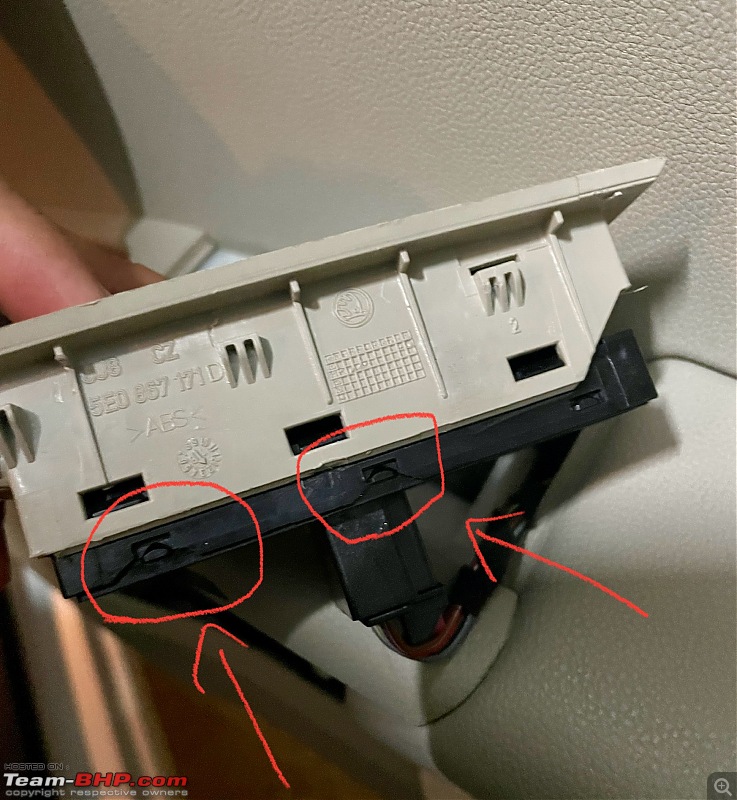

I also encountered a similar issue with my 2018 (3rd gen) Octavia. Initially, the one-touch auto roll-up and roll-down feature for the front passenger side window began to malfunction from the master switch and stopped working entirely within a week, although it functioned normally when using the button on the passenger door. A few days later, the driver side window also stopped functioning. Upon researching, I found that moisture on the switchboard could be the cause, although I usually keep the interior dry. I also found that a replacement switch would cost over 5k plus labor. Since the service center is far away, I decided to open the switch myself to note the part number so I could call the service center and place an order for the replacement part.
With the help of some YouTube videos, I managed to open the master switch only to find that the plastic panel securing the switch lock was broken. Pressing the button was actually pushing the entire board down, thus causing the malfunction.
I used Fevi-stick to glue the broken part back into place and reassembled the switch. Voila! The switch buttons are now working perfectly. I may have saved 5-6k with this DIY.
