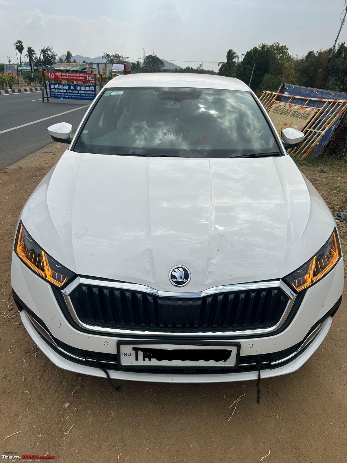

Originally Posted by abaliga View Post
I also noticed that the blinkers on your RHS front headlamp aren't lighting up fully, do get it replaced as part of the claim if it is not working normally, I am sure the headlamps cost upward of 50k each, once the claim is settled you may not have an option to get it sorted as a warranty claim if it was damaged in the accident!
Nice catch mate . I did check about this, Its my mobile camera playing tricks.
Another picture taken wide has both indicators working. Service centre confirmed that both indicators are working fine.
Attachment 2571986
Unless it’s the camera angle, the alignment on your bonnet on either side of the skoda badge seems off.
