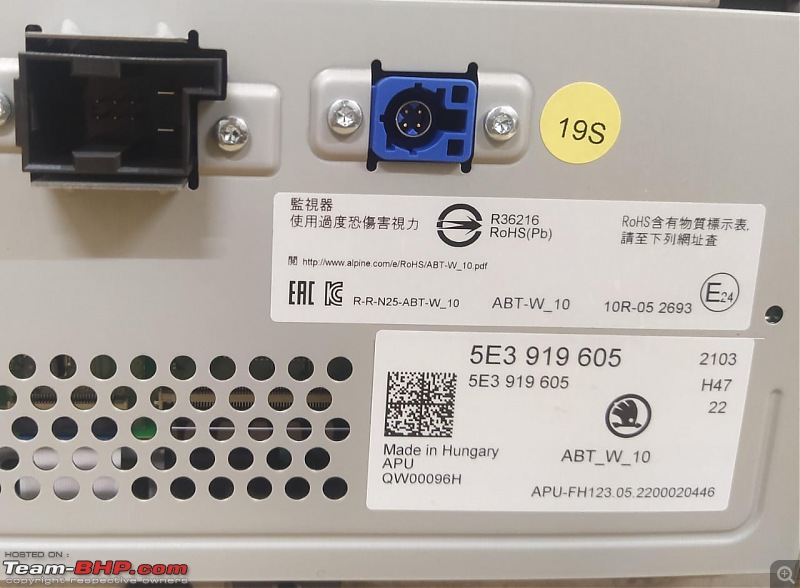

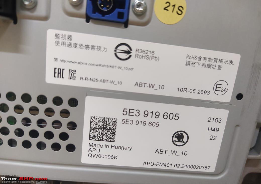

Yes, Infotainment is an issue which is pretty much solved with updated unit. Allow me to cover this here piece by piece.
So as per my last update, it was control module unit which was supposed to be replaced looking at the system data by technical team. Later,on the same day when they checked the consolidated logs, they zeroed in the problem with screen and not control module and it promptly arrived at the dealership very next day to be replaced.
Cost - 117000
Since then, it works like a charm in all permutations and combinations.
I would request everyone to not ignore infotainment issues, however minuscule it might be now. Take as many video recordings for the same to make your case with Customer care and dealership, both. One might have to be stern with them but eventually with patience and persistence, it will be resolved.
All said and done, my experience was traumatic to say the least. I had put it up for sale too only to replace it with Tiguan or A4 but with all the research I had put, neither of the cars came close to what octavia delivers in terms of value and performance, both.Octavia MK4 has that oomph appeal to it and is definitely a head turner among the 3.
I am going to keep it for the longer run now, with extended warranty of-course.
Attaching pictures here for reference:
H47 - Old unit.

H49 - New unit.

Originally Posted by Ambust View Post
Very eagerly waiting for your feedback here.
To update situation at my end and to help out fellow Bhpians, I will be putting chronological order of events here -
April last week - 3rd Glovebox installed under warranty.
Software was updated to 1941.
Driver airbag was replaced.
May 1st week -
Infotainment crashes became more frequent. 5-6 restarts in an hour drive.
May 2nd week - frequency increases to 20-30 restarts in a hour drive.
Escalated to Skoda customer care and Dealer with videos.
May 18th - After seeing no movement from Skoda customer care , I reached out to Skoda top management via Linkedin at around 3 PM. Despite being a Saturday, Top official of after sales did respond to it almost immediately - He trickled down my message to his internal groups and finally I got a call from ASM west at 6:30 PM. He assured me that Skoda’s technical team will check the issue remotely on 20th May and he kept his word. Finally on 20th , CONTROLLER UNIT replacement was approved by warranty team. Part cost - 117000.
21st May - Part arrived at Thane dealership.
Tomorrow, it will be installed and hopefully that should be the last of it. It was a traumatic experience from otherwise a beautiful machine.
My only apprehension is that international posts mention issues with heat management of Octavia’s Screen and @mah45 attests to it since his issue wasn’t resolved after replacing Controller unit. I assume that eventually issue will crop up again leading to a screen replacement as well - I sincerely hope it doesn’t come to that though.
Will keep everyone posted here.
