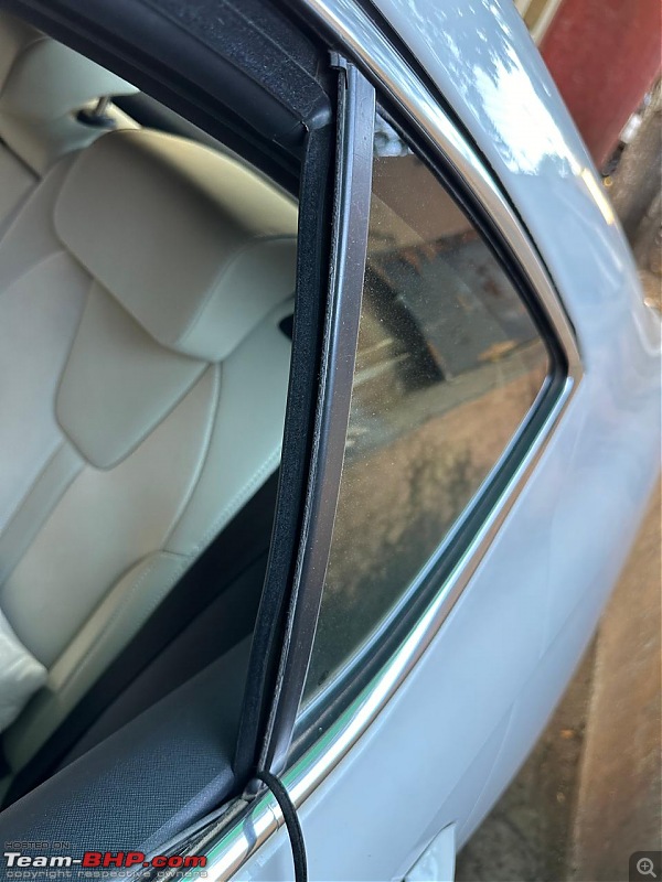

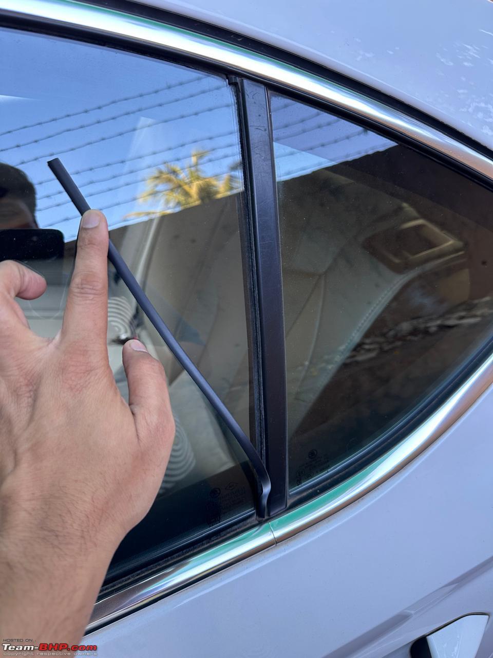

Hi, I noticed this gasket that has broken (rear LHS window from the outside). The service center guys told me that this isn't covered in warranty and a new one costs 20k and recommended that I use adhesive (Dr. Fixit or similar) and fix it at home. Need some opinions if this is the right thing to do. Last thing that I want it for water to seep in during Mumbai monsoon. My car is always parked in the open.
I faced this exact issue in November last year. Upon taking the car to have it inspected by the service centre they blatantly told me someone might have tried to pull and remove it. Now that's absurd because I know for a fact it came off at the seam. Back then they told me the entire quarter window has to be replaced, which costs around 20-25K and which is backordered. So if anyone has a cheap fix, I am listening. Also I don't have the gasket, they threw it away.
