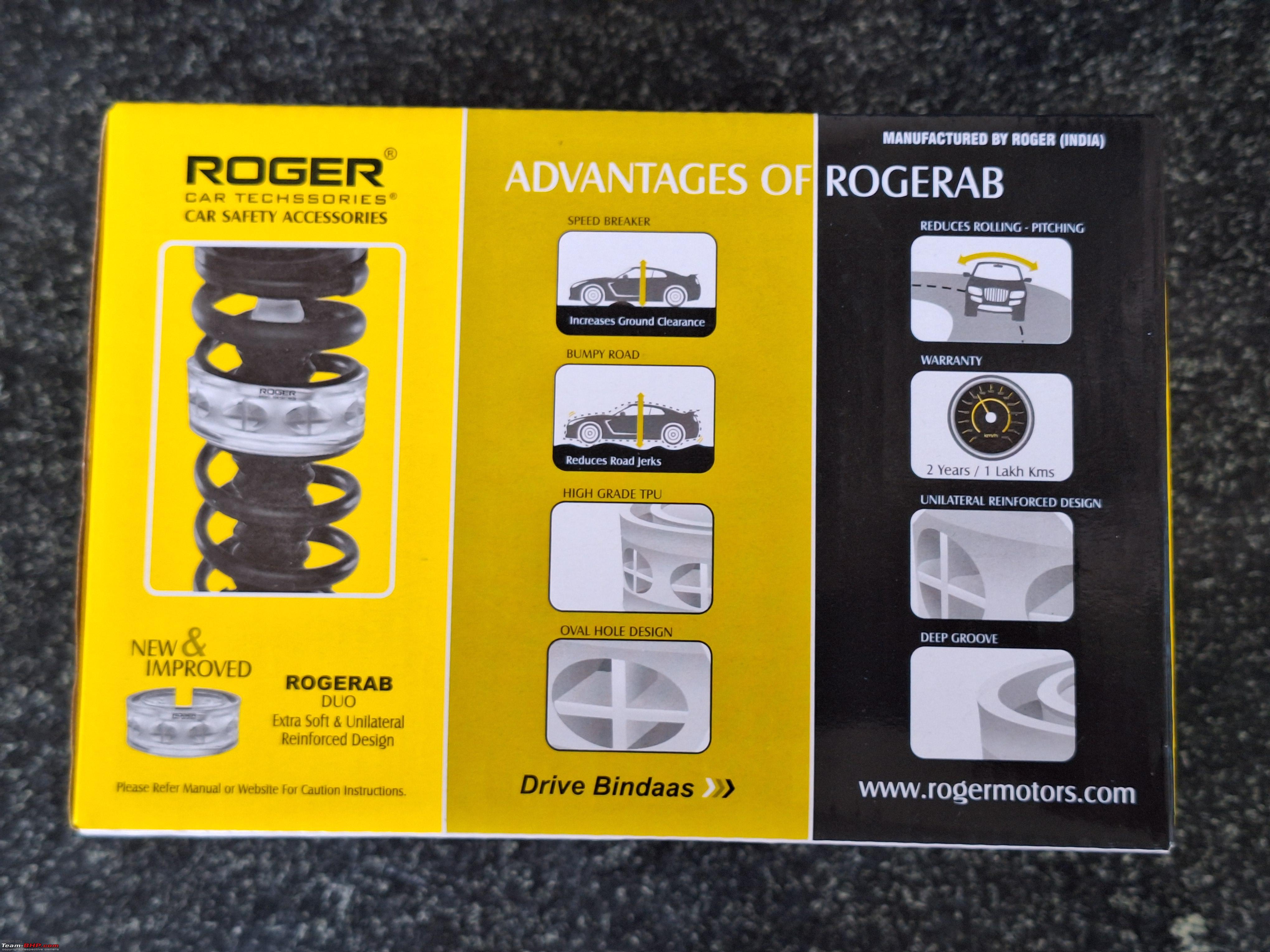

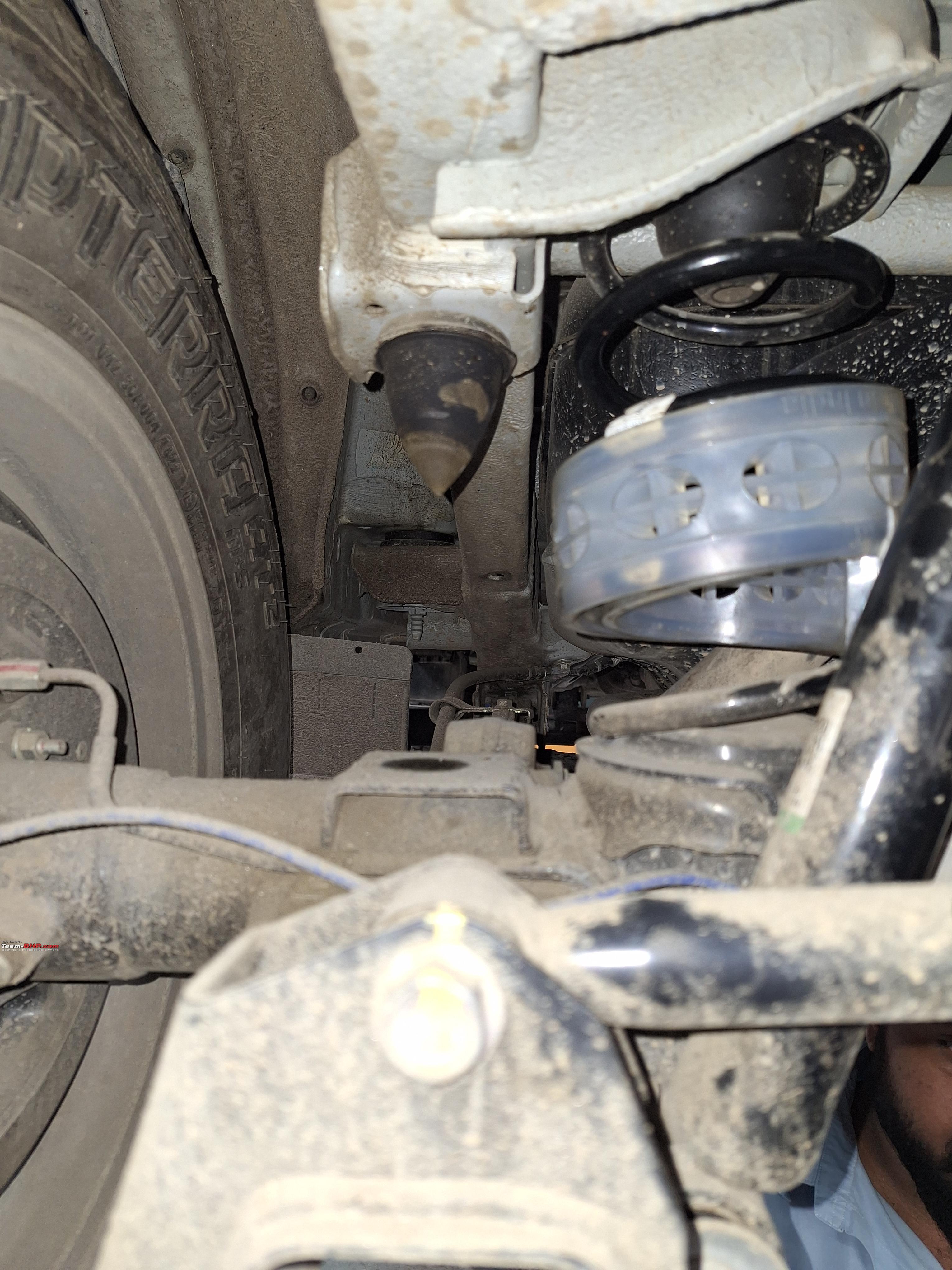

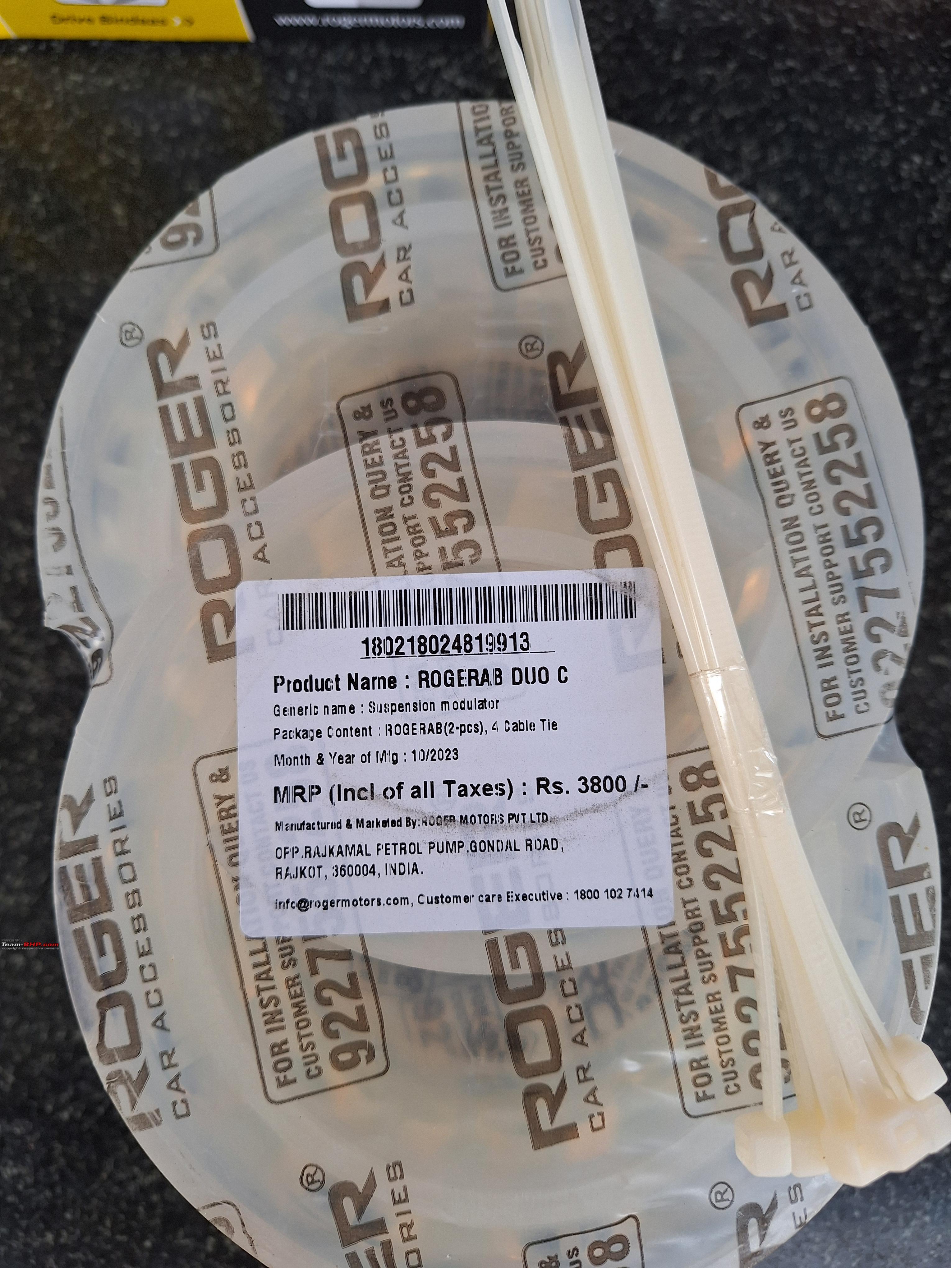

Enough has been said about the Jimny so I just want to post about a major issue I had with the car. The body roll at the rear is horrible and jerky leaving me groaning with an almost vertigo inducing headache. Hence I got the RogerAB suspension buffer installed. The front does not need it as it’s not a problem but for consistency I decided that it was better the spring rate on all four coils at the front and rear was bumped by the roughly the same proportion (and yes this does make for a more consistent suspension performance and behaviour at high speed). Initially there seemed to be little to no improvement for the first two weeks and I was wondering if I should return the product in the 30day return period. Then I realised that since the lower coils contributed most to the softer initial and early compression phase I decided to slide the rear buffers lower down one level on the coils and viola! The body roll is not as pronounced - it still exists but to a lesser degree. The experience of intense momentary irritation and flash headache has toned down by 50%. The car also takes pot holes at high speeds like a champ - much better than without the suspension buffers.
I don’t know if I got defective shocks from factory that don’t damp as well as other Jimmy’s because only few people have reported the problem. In my case it was extremely bad.
As a bonus the body stance has also improved ever so slightly. I did measure the before-install height and then promptly forgot the measurements a few days later so I can’t tell by how many cm the body height has increased. But I am guessing less than 1.5cm. (Next person to install - please do report the before and after body height and tyre profile and pressure).
TIP: Don’t call the home installation mechanic and pay 600/- like I did at first, but take the car the any nearby garage with a lift to install them.
Attaching pics of the adjusted buffer location on rear coil springs. For the front I left them higher up (almost centered) as I don’t feel the need to improve anything.

These Rogerabs actually reduce articulation by retarding the compression of the coil springs. Undoubtedly they work well and I ve seen their benefit in my Yeti and in my Dad’s Glanza. They prevent the inevitable ‘bottoming out’ on our fabulous Bangalore speed breakers.
Saying that, for vehicles such as the Thar and Jimny it is better to consider a full upgrade of the suspension system itself to Ironman or similar. Those dampers and coil springs aid immeasurably in improved handling, cornering stability and damping. However, these are all expensive at Rs 1.2 -1.5 Lacs for a set. Considering the cost, and in case the Jimny is mostly used on paved roads, tarmac, gravel and dirt trails etc, the Rogerabs at 6000 Rs or less, make good sense. However, if you are going rock crawling and driving on rutted tracks you will require the articulation afforded by the suspension and will therefore find the Rogerab modulators in a way counter-productive in those circumstances.
Right, agreed. This is a stop-gap arrangement for a year until the Aussies develop new suspension kits for the 5-door Jimny, once the exports to that country commence. I don’t want to install a suspension tuned for the 3-door on to the 5-door.
That said and being practical - 95% of Jimny owners will never do Rock crawling.
Rutted tracks - maybe 100 meters per every 5000kms?
For the price - I think it’s a great way to postpone upgrading the suspension until you are ready to spend …

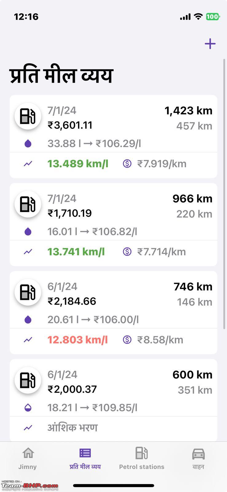

This is 7 days old Black Zeta AT. The car was bought from Madhya Pradesh and will be registered in Pune.
In 7 days, she covered 1500 km. Missed the first free service because of MSIL's different service booking system.
Have planned some modifications but waiting for the registration first so not making any external changes.
Being a daily driver of XUV5OO and Scorpio-N, it took time for me to get used to a lethargic NA petrol engine.
Here are some observations from my side. Not talking about those points that have already been discussed a zillion times earlier.
Good Points
  • The base variant is adequately loaded. The steel wheels are unique and do not warrant immediate upgrade to alloys.
  • Stock tires are best for amazing ride quality. The upgrade will make ride quality harsh.
  • Tank full to tankful method returned 13.7 KMPL (90% highway drive).
  • Adequate space for four and big boot space.
  • The stock music system is better than the XUV5OO stock music system. It is decent enough to live with and does not demand immediate upgrades.
Things that I did not like
  • Buggy head unit. Deleting the previously paired BT devices took ages. Carplay keeps disconnecting.
  • Poor fuel economy in bumper-to-bumper traffic. Less than 8 KMPL.
  • Lower tank capacity and poor FE result in lower highway range thus want you to stop for frequent fill-ups. Generally, my other vehicles do run 900-1000 km between each tankful.
  • The HU brightness and MID brightness do not have auto adjustment according to day and night. MID's brightness is fixed and it burns eyes during night drive.
