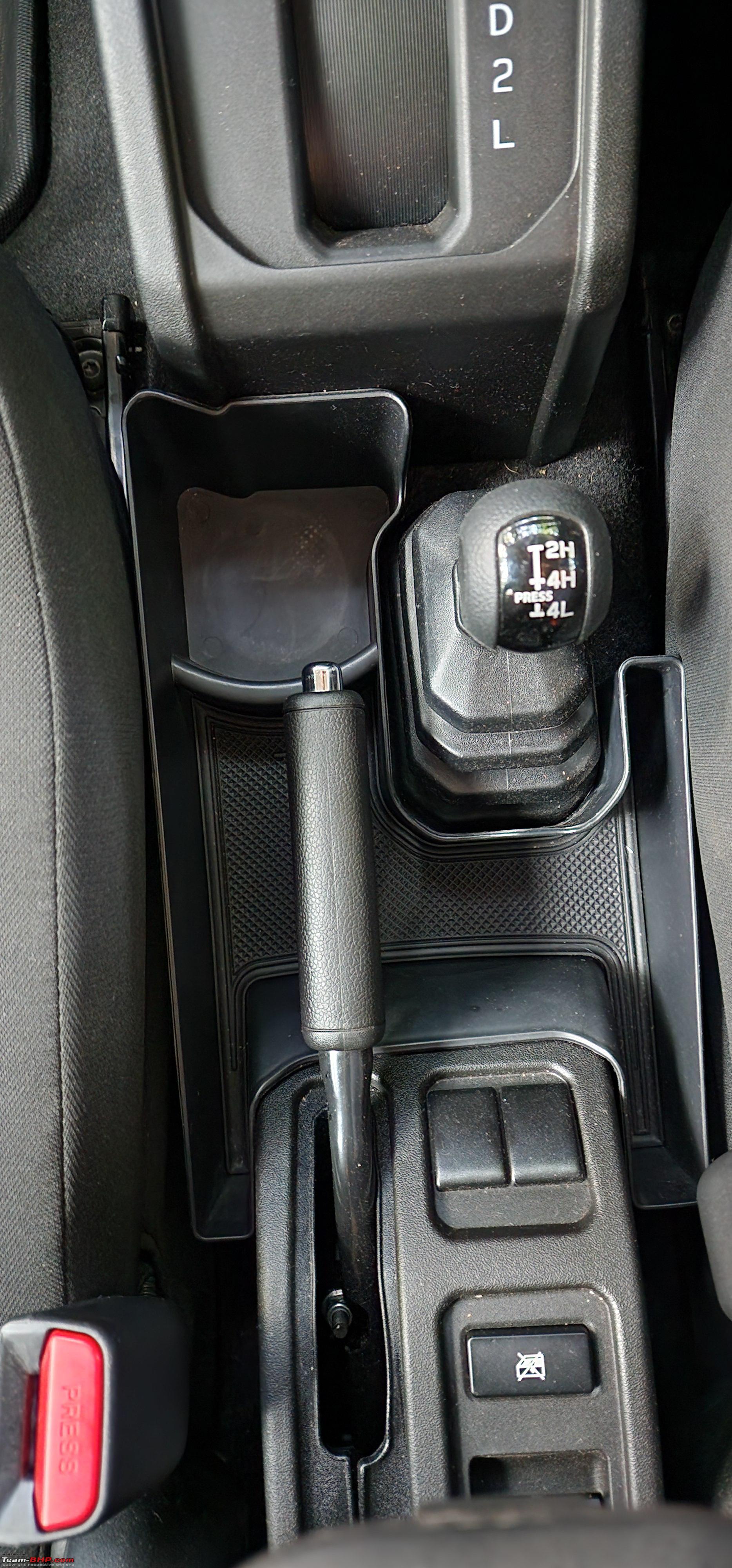

I went to "Learn Offroad" level-1 course with Dr. Tejas last weekend. Loved it. However one observation that I had was that 4L seems to get dislodged in my Jimny when I take her through some rough section. Will check it again this week end when we go for offroading. Has anyone else faced this issue?
The 4L engagement needs a heavy rearward pull along with a press. In my case my engagement procedure wasn't proper initially and took a few attempts to figure out. However if the shifter is getting dislodged after it was engaged properly and the car already started moving in 4L, then it needs to be addressed at service centre.
Kandisa is offline   (4) Thanks
I believe this is the case with my car ( getting dislodged after getting engaged). Tejas Sir is trying to help me get some contact in Maruti Bangalore. Dont want to take my vehicle to regular service station as their understanding of 4wd is minimal. Will update once I get it checked.
If you have the floor mounted storage, please remove that and check.
Although we get a feel that it is engaged, it is not actually engaged completely. The floor mounted storage tray obstructs the lever stick a little bit. Removing that will enable pulling it completely.
Additionally I got a lever extender from Swastikfabs which now makes it easier to shift especially to 4L. With additional length, there is some lever vibration but that's not a big problem

[quote=hemanth.anand;5701978]If you have the floor mounted storage, please remove that and check.
I have not installed the floor mounted storage. I will take the Jimny for some off-roading this weekend and check it out. The extender looks interesting.
