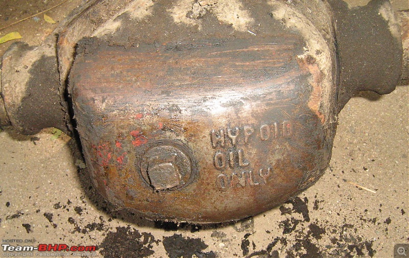

BTW,found this neat little instruction on the rear of the diff.
He's tried again to open the rear drums using a puller at the lathe machine guy's but that broke too! So had to go with him and buy stuff to fabricate a new puller.

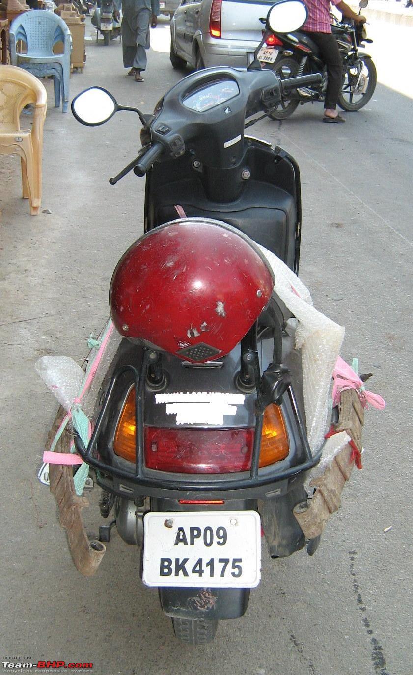

Also reg. the leaf springs, turns out that one is missing from each set (total 6+6) so he intends to put replacements from Landmaster springs, they being similar.
Also he had a different opinion about getting the leaf springs clean- I ended up not getting them sandblasted last sunday, as he insisted that there is no need, since the guys who set them would first clean them in acid, then heat them and then hammer them/set them straight with a machine.
But fortunately or unfortunately, he was told that none of this would be done when he went to handover the springs today!
So he decided to go by my way of taking them for sandblasting! Then have them set straight.

Rear springs were given for sandblasting yesterday, at the place that DKG had guided me to. The guy there said we could get down anything to be sandblasted (but NEVER body-panels btw!)
He insisted that we have to first dismantle the springs separately though, which would be done later, as we have to anyways go there again to give the diff/axle for sandblasting too, most likely tomorrow.
And here's a novel way to carry a huge pair of leaf springs when you don't have convenient enough transport!
'didn't have too much of a problem with it. The rear axle/diff. would have to be carried by car though.
Continuing on which, no luck in opening the right rear drum again! 'had fabricated another puller, which was the 4th one this time, to open it......only to break it again!!
So, my mech. had another ruse now, to drill out the 4 bolts retaining the backplate to the axle flange (arrowed) on either side, and separate the 2. Then work on removing the drum.
And much to my surprise (and relief), when I went to check today, I saw that this has worked- the backplate on one side has been successfully separated and even the drum opened up! The axle shaft too has come out separate! hew:
Now if the same thing happens in case of the other drum, then nothing like it! Only the diff. would have to be opened up next and the whole external assembly (except maybe the backplates and rear axle housing) given for sandblasting.
