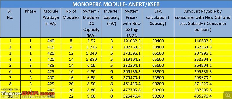

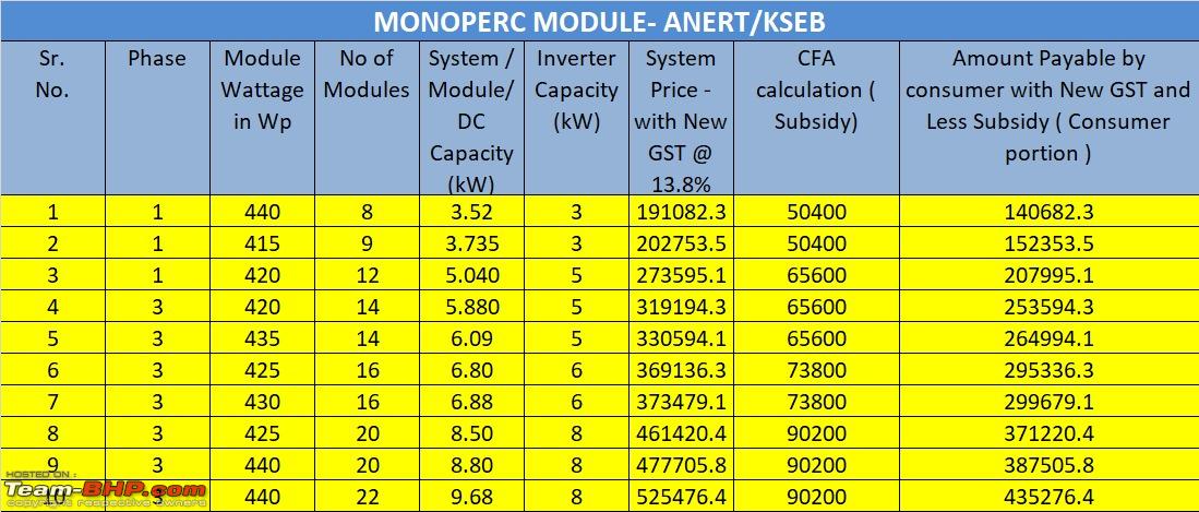

Old 8th January 2023, 09:27   #205
di1in's Avatar
Join Date: Jan 2009
Location: Thrissur
Posts: 511
Thanked: 293 Times
Re: Solar power! Turning my roof to a power plant
Originally Posted by Remsoft View Post
Hello, BHP's,
My house is being built in Chennai, and I have a quote for installing solar panels.
The cost is Rs 2,25,000 for a 3KVA plant, but they will receive TNEB clearance for 5 KVA depending on the usage they indicated, and extra panels can be added.
Please let me know if you recently installed solar panels and how much it cost.
Attached is a table of cost and subsidy that was available in Kerala in 2022.
Here are some other points that might be of interest based on what I learnt from implementing roof top solar at my home:
1. 250 units/month is the max consumption for value for money from KSEB. If you go one unit above to 251 units, your bill increases by ~₹350. Your states board might have a similar sweet spot.
You can use this to plan for your solar plant capacity, if you can’t cover your whole consumption, at least plan for it to be below 250 units/month or it’s equivalent in your state.
2. If there is partial shade where your panels are to be installed, then connecting them in series will decimate your plant production and also cause hot spots. So plan for this when picking a spot.
3. Partial shade situations can also be caused by over enthusiastic birds pooping all over. Plan for this with Some brands (like Tata solar in my case) offer free cleaning of all panels every 2-3 months for 5 years.
4. Most of our vendors don’t provide this, but they agree it’s a life saver over the long term. solar water drainage clamps can be installed to properly drain rain water from panels, thus preventing stains and dirt collection at lower edges — if unchecked these are the most common cause of under performing panels in rainy areas. These just cost around ₹300 for 10 pieces.
5. Cooler panels are more efficient. Don’t place panels near chimneys or multiple high capacity AC compressors.
6. Monoperc is better (can google this out for your use case)
7. Take pictures of your new net meters readings in the initial months when KSEB comes in for meter reading, and see if values and dates match.
8. Let maids know to not help out by cleaning the panels with a dirty floor mop 😅
