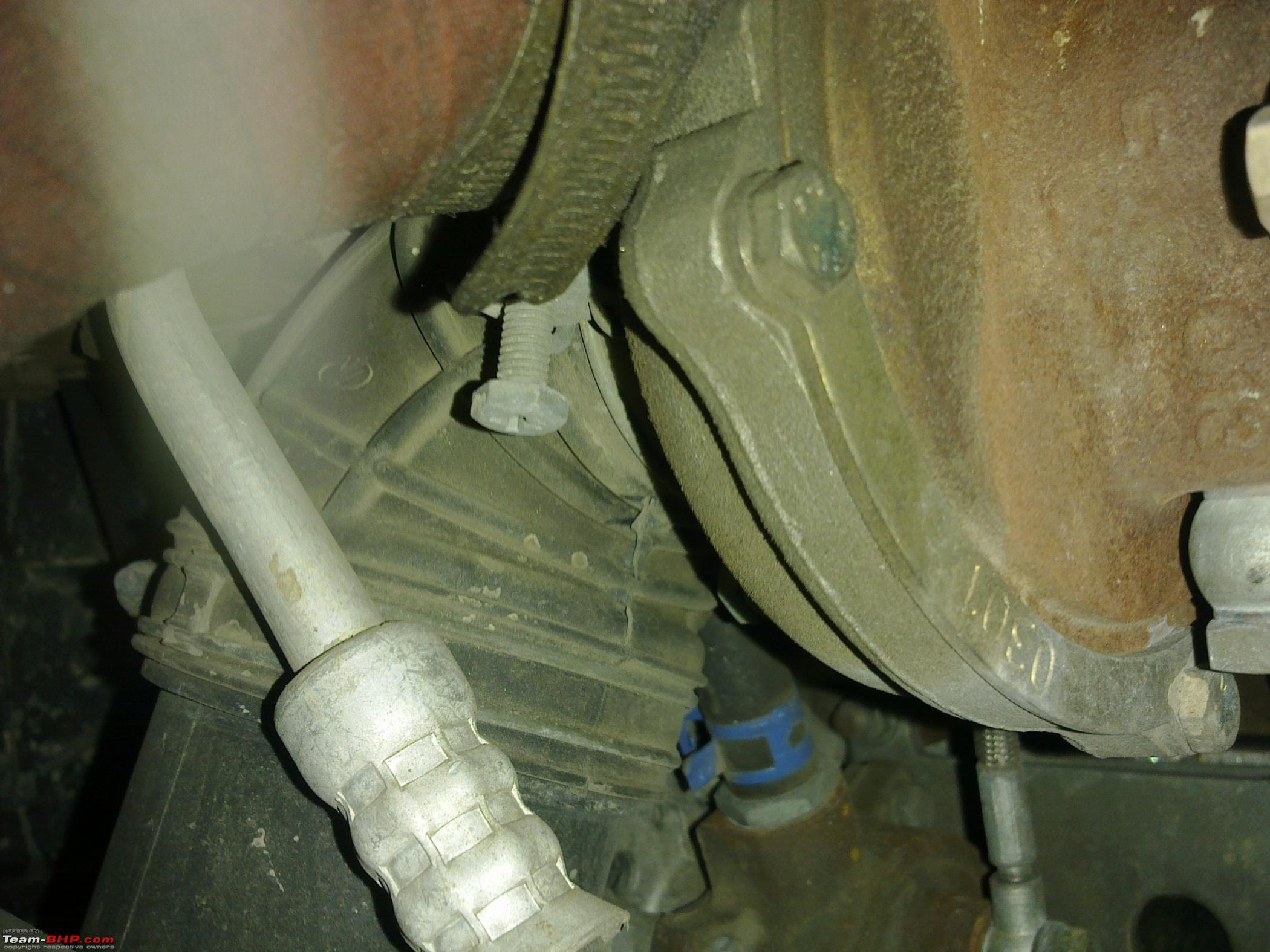

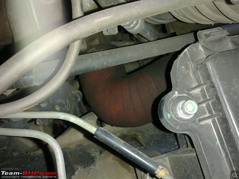

One thing that I noticed today when I had taken Hariya for his first wash after coming back from Lucknow. I hadn't driven him since then.
On the orange hose that goes downward from the tc, I had noticed slight traces of smoke (black hazy lines) on the pipe a few months ago. The traces however, did not increase or decrease.
Today, I noticed that the pipe had oil and consequently dust on it. Oil was not dripping and the pipe was not fully covered with dust but yes, it felt oily and dusty to touch. I m posting a few pics of the same if they help clarify the situation.
What is your take on this? Could this be one of the reasons? I still see no loss of pick up, black smoke or any other outwardly symptoms.
One more thing you can try out.Hve you cleaned the Air Mass Sensor ?
This sensor is located just after the air cleaner on the intake pipe of the Turbo. Remmoe the sensor and clean it with kerosene or Diesel Blow air into it and refit the sensor. This also my previous advice look up if there is any obstruction between the accelerator lever like carpet or rubber mating. Because you have clearly mentioned that the pick up is ok.
The oil coming out through the pipe is ok nothing to worry abput. Just make sure that the pipe especially in the second pic which tends to tear apart leaking air pressure to the inlet of the engine.
CRDIsamir is offline   (1) Thanks
